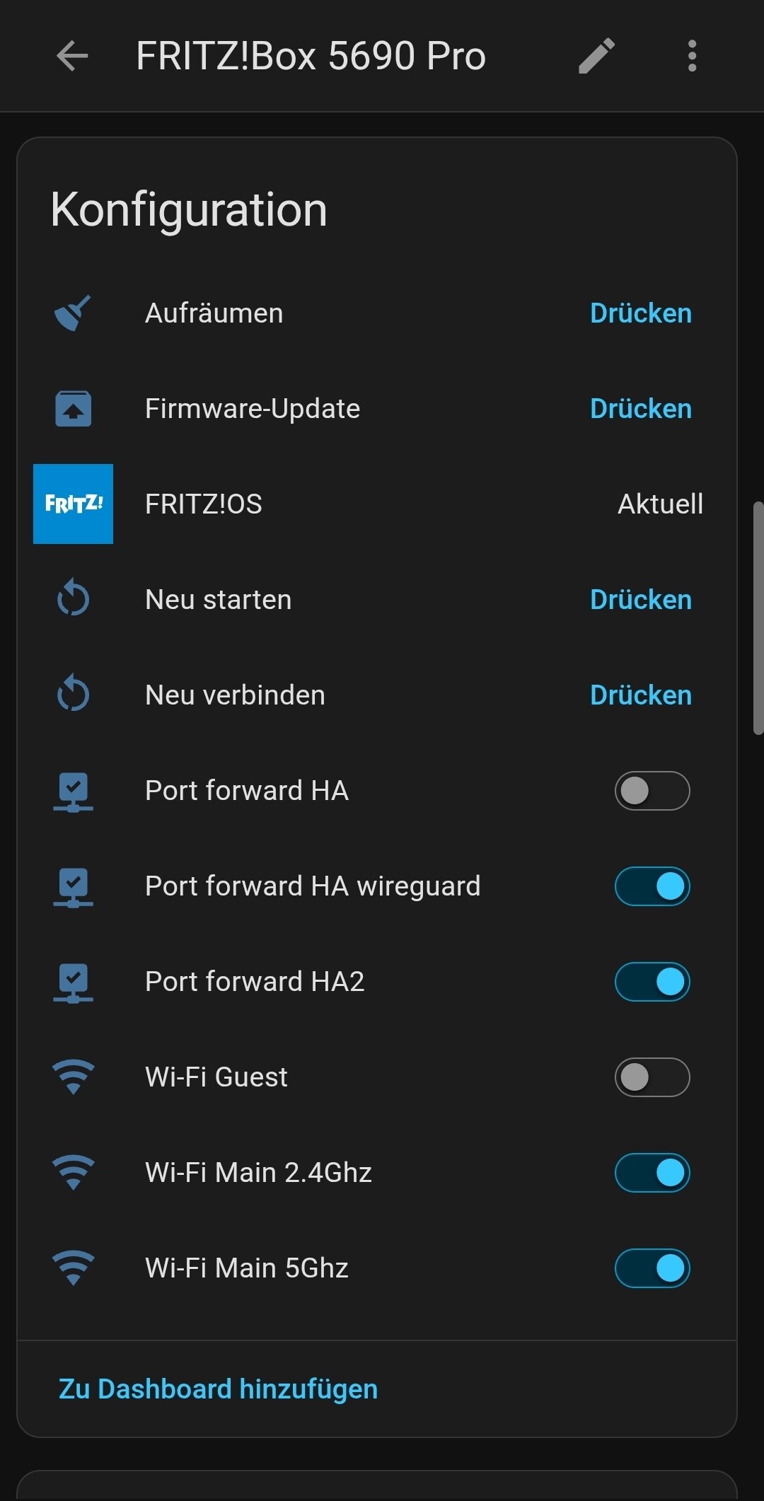

I use the FritzBox 5690pro and its integrated in homeassistant through the FRITZ!Box Tools integration (as part of homeassistant). There you can turn the 2.4Ghz and 5Ghz WiFi on and off. Its a "configuration switch"
So until the last update this 5Ghz "switch" was turning my 6Ghz WiFi on and off.
Now its turning the correct 5Ghz WiFi on and off.
But i would like to have an additional "switch" to turn also the 6Ghz WiFi on and off.
In the screenshot you will see which switches i mean.

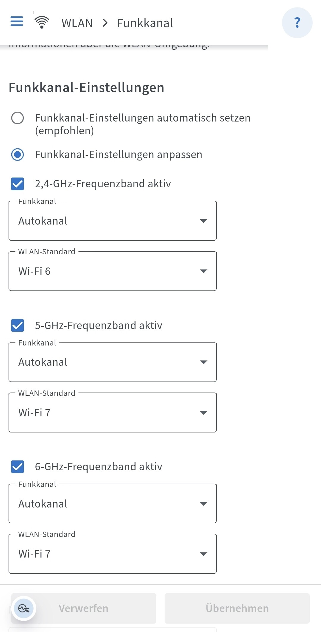

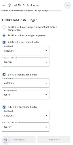

But technically in my FritzBox i can turn on and off each network independently. I can turn off 5Ghz band and leave 6Ghz on and turn off 6Ghz and leave 5Ghz on. And the 2.4Ghz independent too.

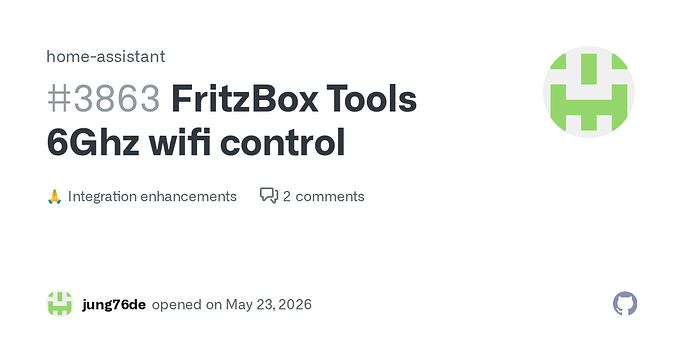

Sounds like a bug, regression, or enhancement request. Have you raised the issue in GitHub where the app developer will most likely see it, rather than read this thread?
When you do, please link it back here for others that may be interested in the outcome.

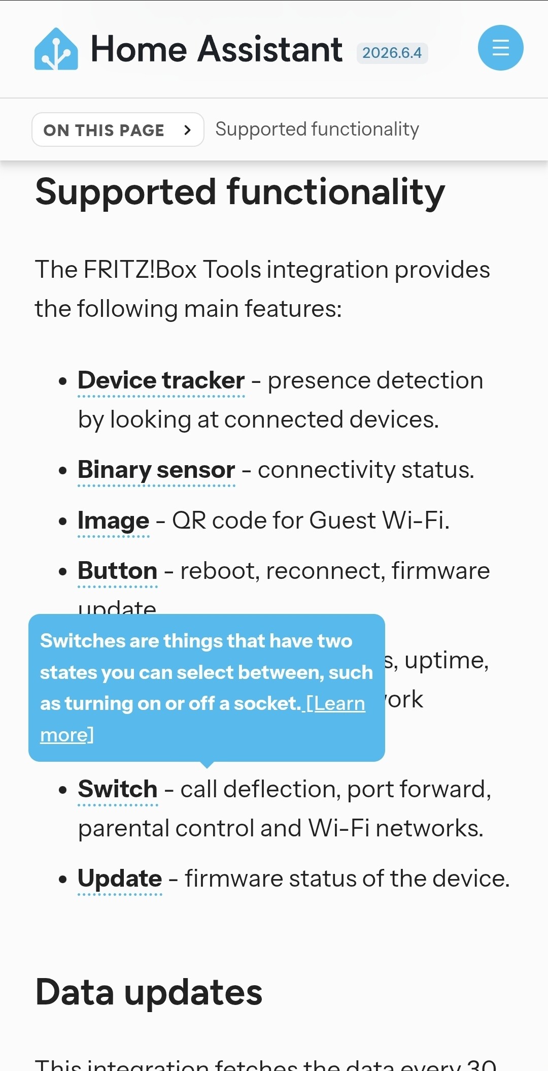

It's called Switch WiFi network at the homeassistant integration site.
I added request at github. Bit seems I'm the only one switching this WiFi pn/off.
