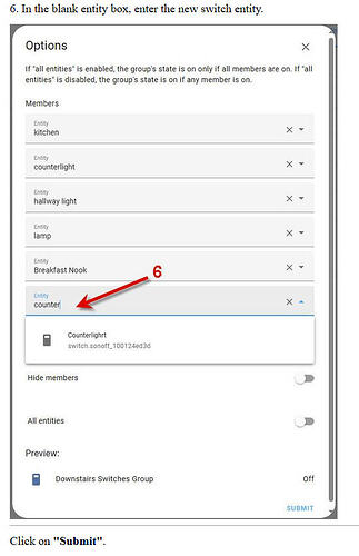

Here are some pages from my notebook that might help:
