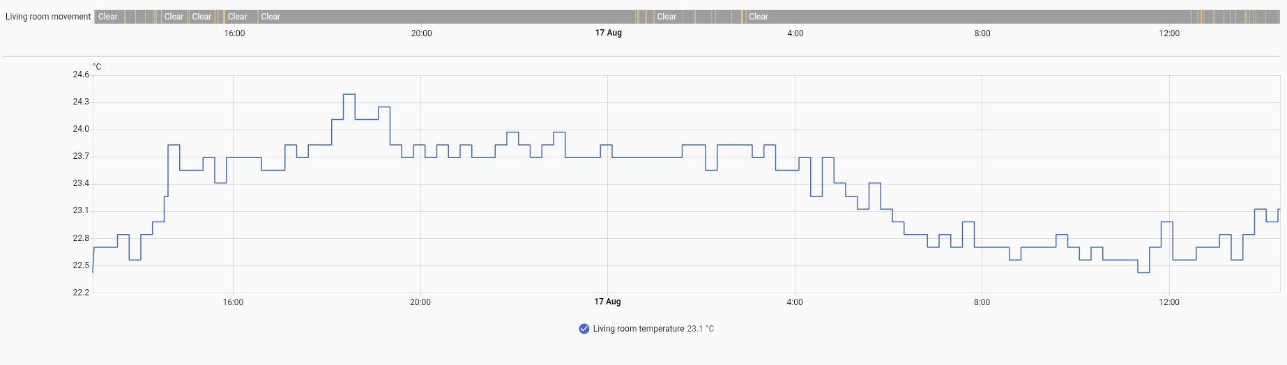

It seems to me that a thermostat is only a switch. Since I have a temperature sensor in every room (in the motion sensors) it ought to be relatively simple to turn the boiler on and off according to the temperature in rooms that are occupied.

For clarity… The motion sensors are Philips Hue - they provide regular temperature readings even when there is no movement.
