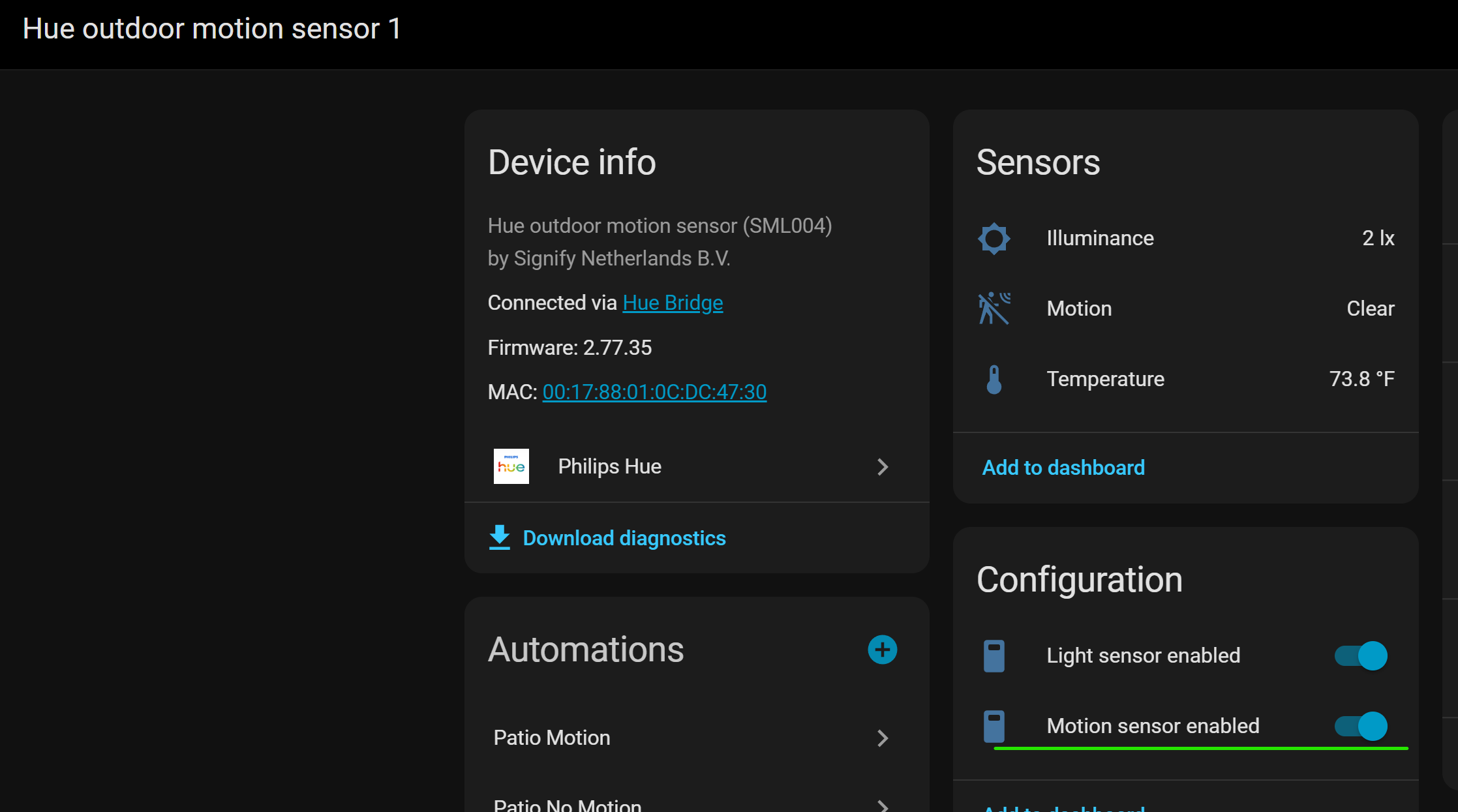

I have a Hue hub connected to my test HA system. From what I see, even if the motion sensor is installed via the Hue hub, the sensor should have a switch available in HA that can turn the motion sensor on and off.
If the Hue motion sensor is turned off via HA the Hue automation doesn’t execute.

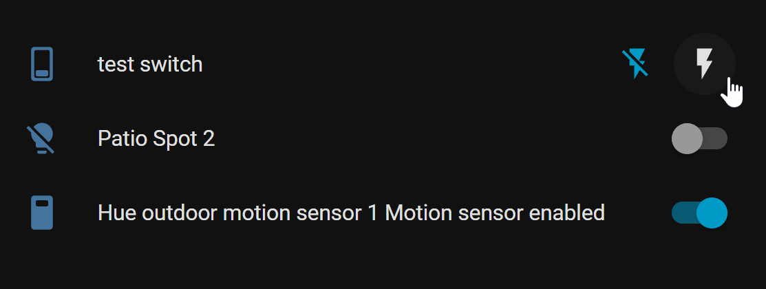

HA Template Switch Actions
  • Turn ON -turns off the motion sensor and turns on the designated light.
  • Turn OFF -turns on the motion sensor and turns off the designated light.

Test Switch
This is exactly what i am looking for? I think may be I have over complicated it with my explanation. I have a motion sensor in my kitchen that controls my kitchen lights. If i press a switch I want it to disable the motion sensor and turn on the light so the light stays on until I hit the switch again to turn off the light and re-enable the motion sensor. How do I set that up please?
this helped me figure it out by steering me to the templates section. It feels a bit disingenuous to say I figured it out. You gave me a massive clue and I did a bit of trial and error. It’s working and i got what I wanted and I couldn’t have done it without you, cheers :+1:
