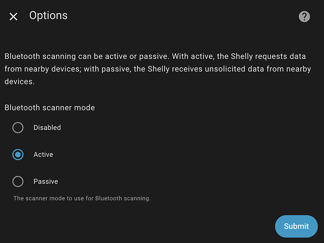

HA didn’t autodetect, after manually adding switchbot integration i received that no devices were detected and i might try switching my gateway to ‘active’ scanning (which I did)…
Shelly’s don’t allow for active BT connections in HA (which the switchbot requires). The active option you selected is just a mode where they periodically ask any nearby devices to send out their data, but it’s still just passively listening to the data they broadcast (so no back and forth communication).
I assume this is something Shelly has enabled for their hardware specifically (never used them), but for anything that requires Home Assistant it unfortunately won’t work.

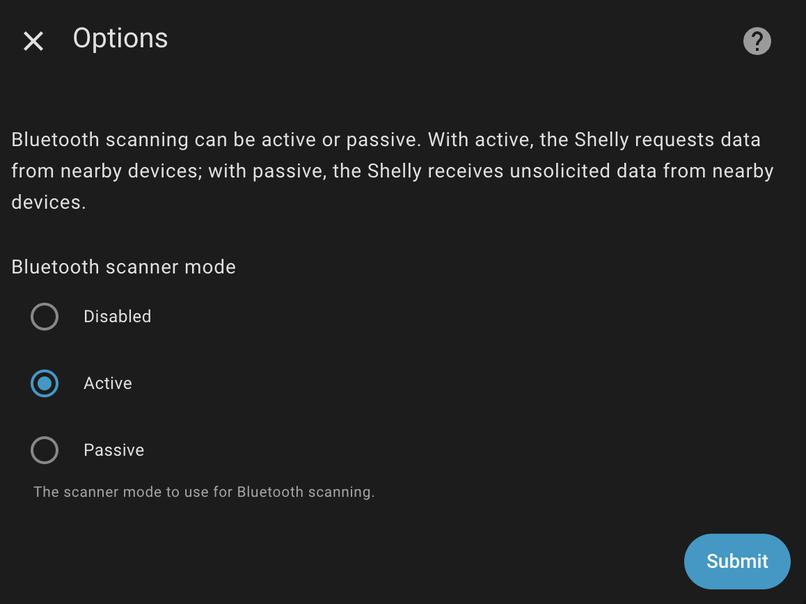

But there is an option in HA to set shelly as Active. Doesn’t it mean that Shelly allow active BT connection in HA?
Nope, that just means it’s actively sending out a request for devices to transmit their data; it’s still just one-way communication.
