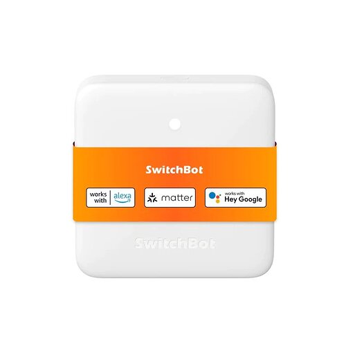

Switchbot Hub Mini Matter - Offline mode (seems to work)
Just an FYI for everyone before you buy it.
This little piece of plastic waste stops functioning, as soon as outbound internet access is blocked for it.
I absolutely cannot believe Switchbot got a "works with Home Assistant" certification, when the damn thing can't even function in offline mode. That's just crazy.
I certainly can understand your frustration at having something that isn't truly local only, but in fairness, that product, at least from what I can see, does not carry the "Works with Home Assistant" badge. Products are certified for that, not companies. Here's a list of all the Switchbot products with the "Works with Home Assistant" certification.
As I said, I don't see anything called with Hub Mini Matter in that list. Maybe I missed it?
Thanks for the fact check, I certainly understand how that certification works now.
As for the product itself, I'll correct myself again, for now it doesn't seem to go into zombie mode, as soon as I allowed access to 224.0.0.251:5353/UDP
Got really pissed for a moment there.
