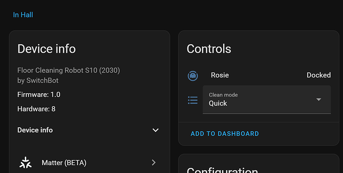

Yep, that’s it. Not much in the way of properties available of the S10… just the “Status” and then, it is wrong. When I ran the S10 today, the status remained at “Docked” for about five minutes. What? Then it did finally change… to “Error” though there really appears to be no error. And stayed at “error” for about 12 hours thus far.
So, is there a better way to get data from the Switchbot S10? The S10 app on my phone shows a lot of different status, and does so quickly. It isn’t that the data isn’t there, just isn’t making to HA.

Don’t know if there are any changes in the information that is presented when running, but the firmware and hardware values displayed in Home Assistant are the same, as are the controls.
For such an apparently capable device in other respects, there is a surprising lack of information presented to the automation system. What’s the status on the consumables? What about some means, through HA, to command the robot to clean a specific area? Map data about where it is? History of what its done? Maybe I’m missing something?

This afternoon I sent the S10 on a cleaning run using the phone to initiate task. The phone’s data responded immediately. Home Assistant’s data on the S10 didn’t change for three minutes. When it did, the only change was to say that the robot status was “error” though this was never indicated on the phone app. The “Operational state” of the S10 never changed from “unknown,” before, during, or after the run. If there was communication to Home Assistant, it was not in evidence.

The S10 exposes a paltry number of options to HA:
Status: I’ve only ever seen “Docked” and “Error” though the “error” is in error.
Control: Start, Pause
Clean mode (Quick, Auto, Deep Clean, Quiet, Max Vac)
Operational State (all we get is “Unknown”)
And one control has apparently already been deprecated: Identify. I’m guessing this was supposed to get the S10 to announce itself in case it gets stuck and we need to find it. A marginally useful function, but even that was removed.

I provide an abridged version of that, along with these pics:
