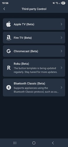

Now from what I have seen I need to go to the Universal Remote and under the “manage devices” choose + and “Third-party control” and from there choose “Matter”, But I do not get this option …

I believe you are using an Android smartphone, correct? You need an iPhone to enable this. Afterwards you don’t need the iPhone any longer. I told Switchbot about this some time ago but it seems they are ignoring this.
I Do not have an iPhone :grimacing:
There is no other way to do this with out an iPhone ?
I don’t think so unfortunately. Can you borrow one from a friend? Only takes a few minutes.
and than I can delete it from their phone ?
yes you can. Strange I know but I did it that way and it worked.
