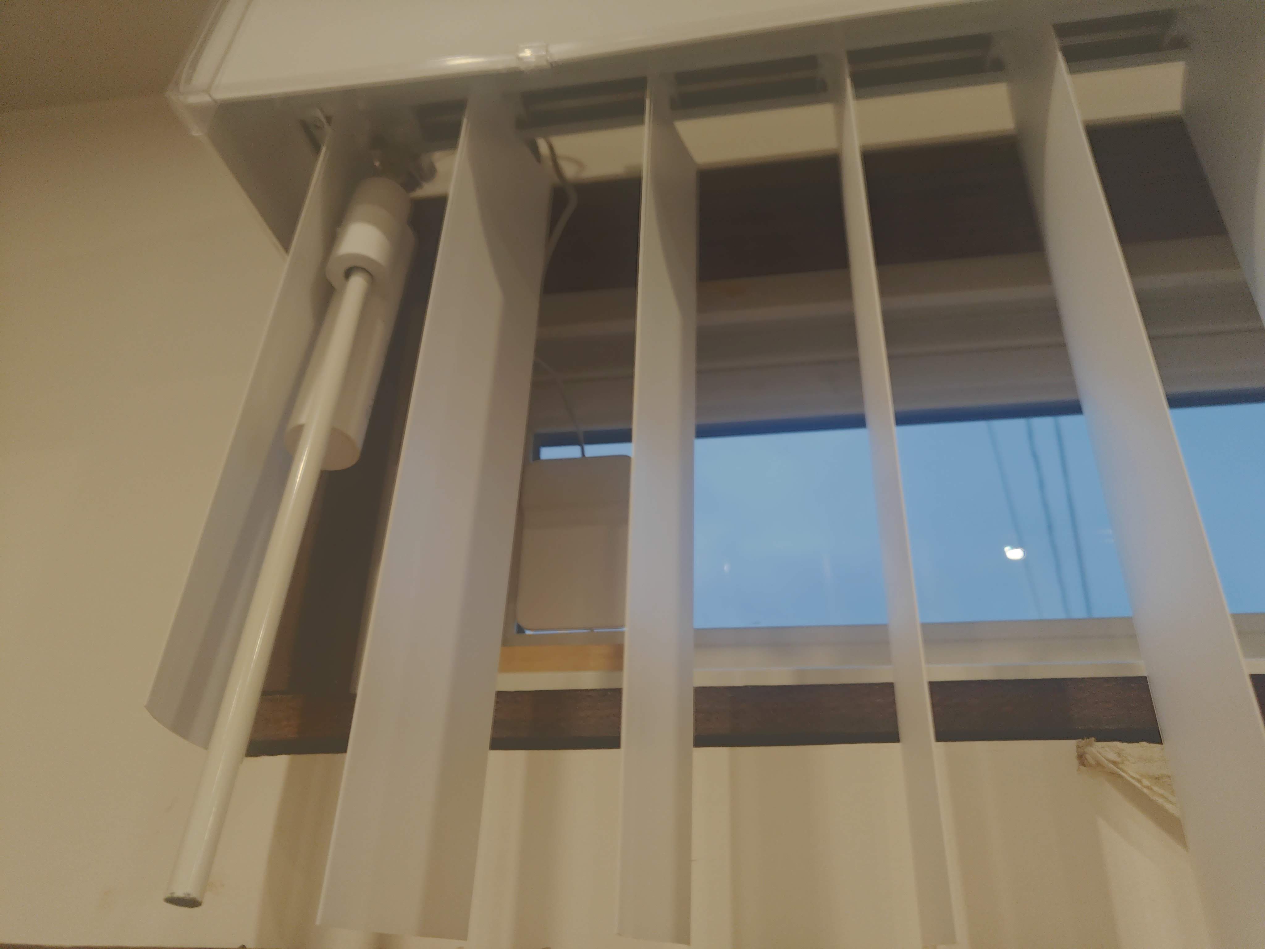

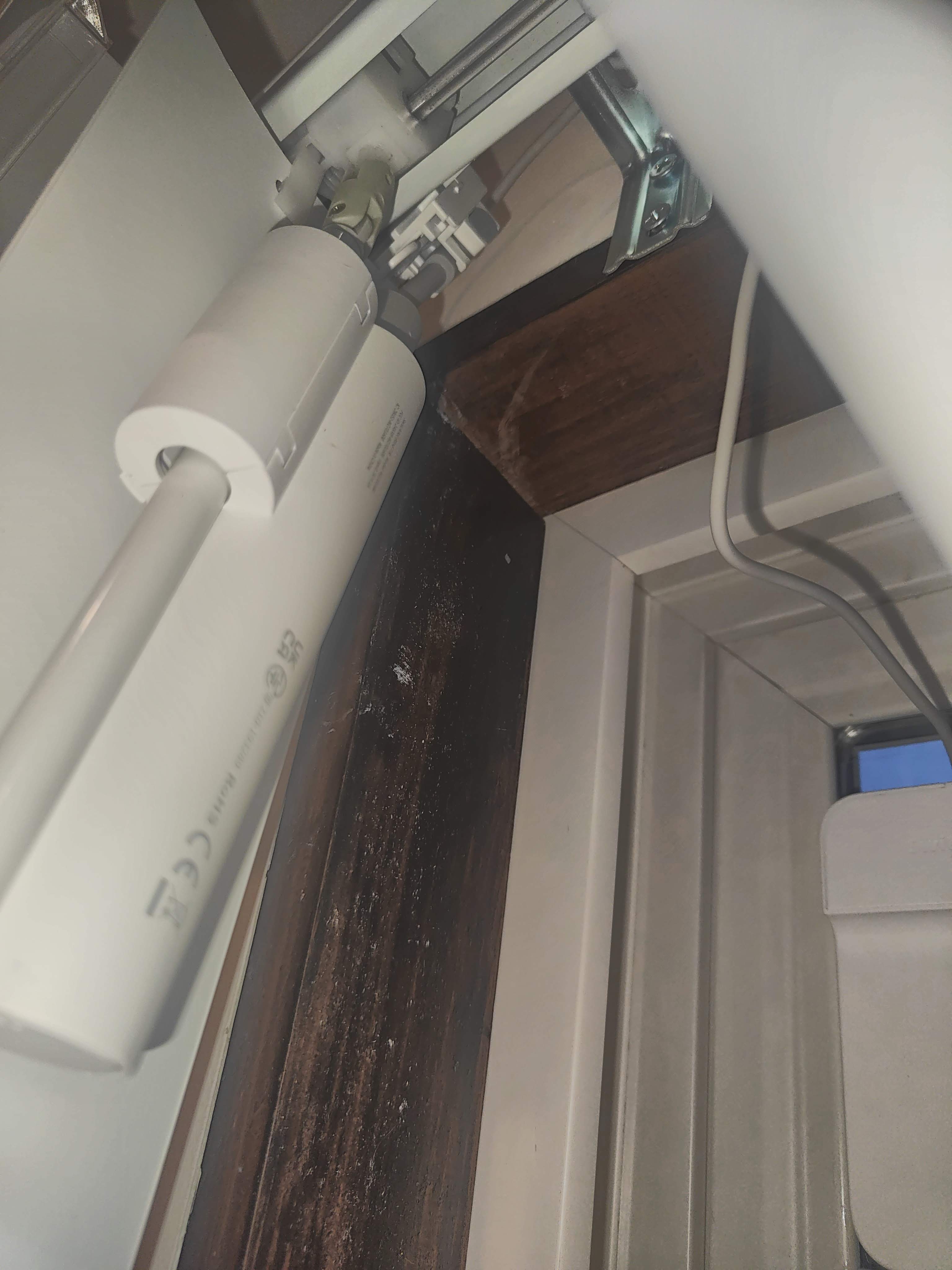

I realize it wasn’t made for the job, but I use the Switchbot Blind Tilt to rotate my vertical blind slats, and it works great. Of course you can’t slide the slats open from whatever end you install the tilt, but after some simple surgery on the headrail, mine now slide from the (fornerly) fixed end. Just be careful not to remove all the hangers from the headrail because they will get twisted around. Depending on the brand (mine is whatever HD or Lowes sells) it can be a PITA to get the slats re-aligned, and mine are still not quite right.

Interesting. Can you post a pic showing more or less how you set it up?
Here you go! Let me know if you need more detail.
The only problem I had is that I misjudged where the parts go when I was installing, so the mounting base (part that sticks to the headrail) doesn’t quite reach and keeps getting pulled off. This makes the wand wobble when it turns and makes the whole process a little choppy. These blinds are only used in an automation that rarely occurs so I haven’t bothered to try to fix it.
I did mount the mounting base on the back of the headrail (instructions show it on the front) so that the contraption is behind the vein when they are closed. It pushes the vein out a little (though that could be because the mounting base doesn’t stay put).
Good luck! Keep us updated on your project.
Thanks! Your blinds are just like mine. The Sunsas push the vane out a bit too and on some blinds they push so much that the mounting base kept coming off. Had to use heavy duty double-sided tape. But even the stock dumb wand pushes the vane, so that’s rather a design quirk of these blinds.
