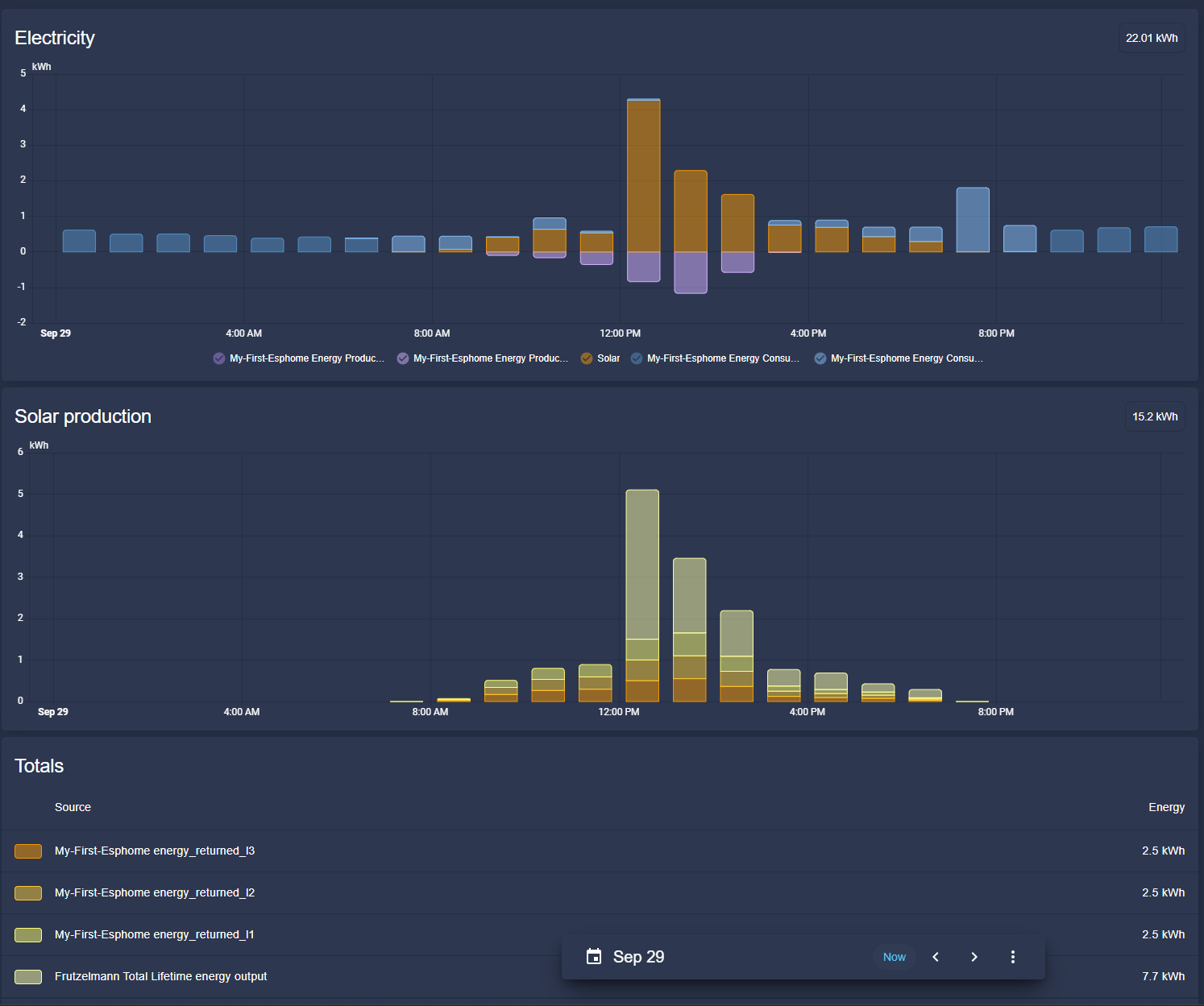

I have created an integrator helper that calculates the energy by integrating the power returned on a phase that does not have any consumers on it. This solved my problem for a few days. But today, after a reboot, the Growatt server has come back. And it spoils my measurement of course, because now I get a big spike for all the enrgy produced by the panels in the last couple of days.

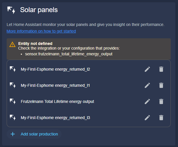

The first thing I tried was to remove Growatt’s “Total Lifetime energy output” as an energy source from the Energy Dashboard. As expected, that killed ALL the history I had from the past year. So I added it back.

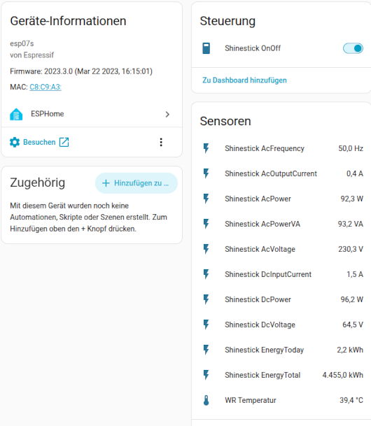

The cloud-based Growatt HA integration has always been a bit of a headache, as Growatt frequently introduces changes that lead to connection issues. I integrated my Growatt inverter locally into HA using the ShineStick WiFi years ago, and I haven’t had any problems since.

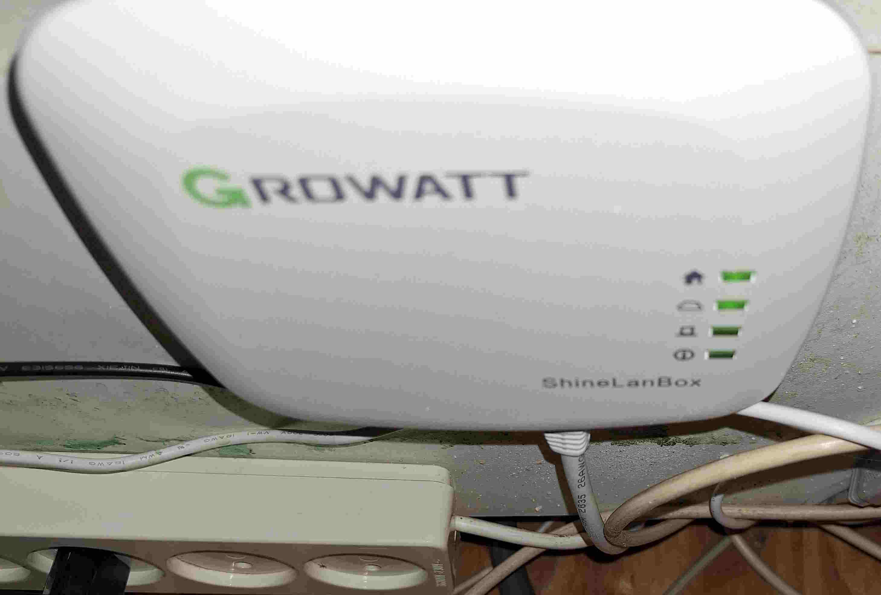

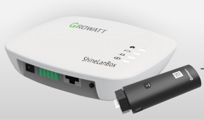

the Shinestick won’t fit on my inverter, instead they have installed a thing that looks like the Shinestick, but is in reality a proprietary wireless thing that connects to a “SineLanBox” in the utility closet downstairs. And that is plugged into my Ethernet to connect to the Growatt server.
I hesitate to buy extra hardware, especially when I am not sure it will fit my installation.
The guys who installed the panels had almost left without even installing this gadget for me, but I refused to sign their papers before they had given me a way to measure the performance of my panels (as they had pormised in the quote before installing).
Yes, Growatt used to offer a ShineLanBox + Wi-Fi stick combination.
However, it seems to have been discontinued.
The question is, which inverter model do you actually have? Normally, it should have other ways to access the data. Without knowing your exact inverter model, if the Wi-Fi stick that came with the ShineLanBox works, then a ShineStick Wi-Fi or a ShineWiLan-X2 “should” probably work as well.

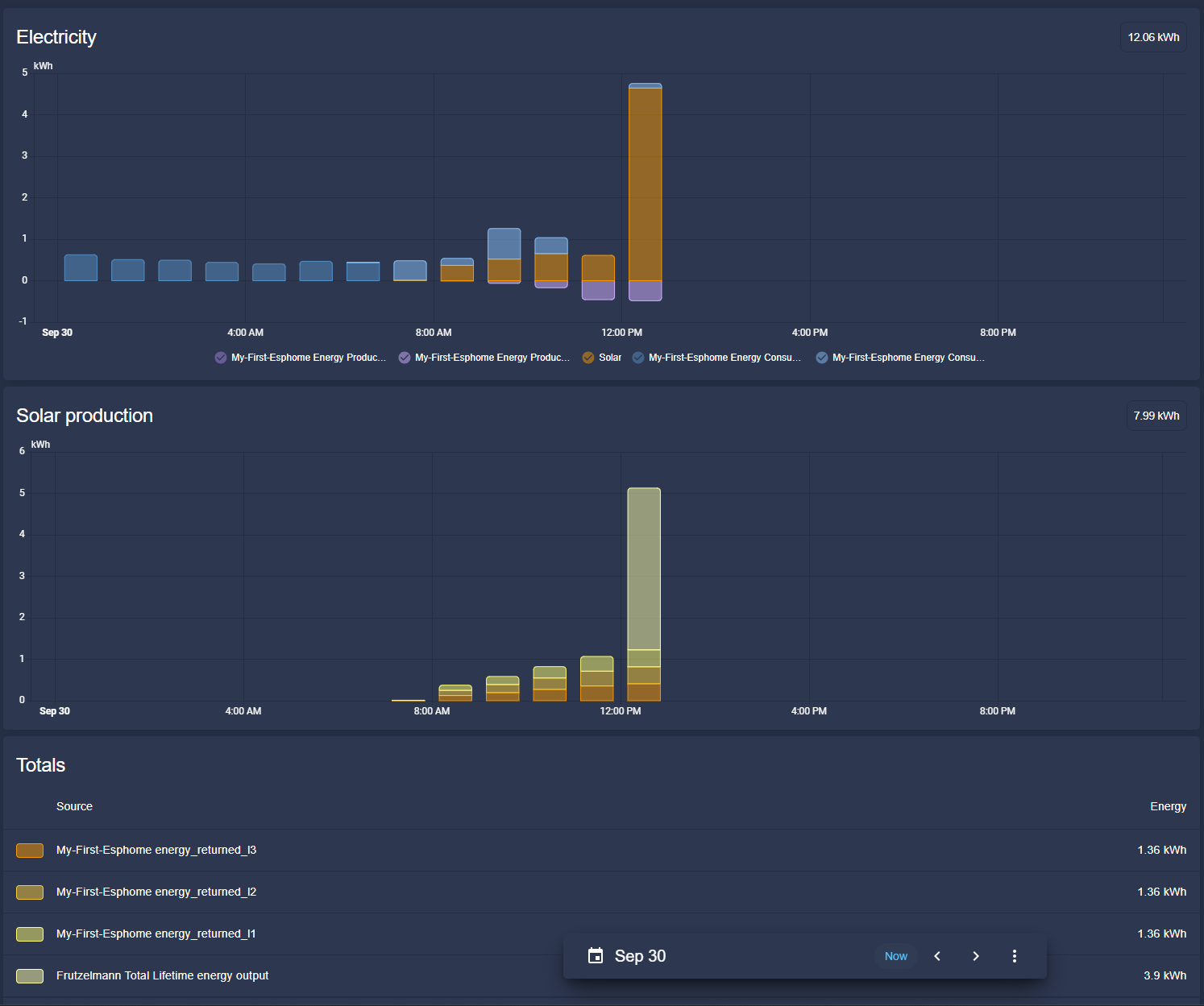

But even if I find a better way to monitor my energy production, the “Ghost of Growatt Past” is stil haunting my Home Assistant setup. I thought I had killed it by editing /etc/hosts , but yesterday and the day before yesterday it came back at noon. (Not at midnight as most decent ghosts do.) That looks like this:
I am curious if it will re-appear today at noon too. There must be a place somewhere where the real IP-address is still cached…
Right on schedule, the gost is back:

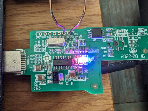

For my stick, the Shine Wifi, flashing any custom esphome fw would require manually soldering two pins together to put it in flash mode. Was scared of doing that bc I’m no solderer so I used the grott solution instead. ESPhome would certainly be cleaner tho
No, there’s no need for any soldering; you simply need to create a temporary bridge using a small wire (or a “paperclip”, if necessary).
In other words, it’s a procedure that pretty much anyone should be able to handle. :wink: You can find various guides for it online.
And yes, you will come across guides where users solder the wire in place, but that’s complete nonsense and entirely unnecessary. :laughing:
ah, didnt know that! Thanks! Might give that a try.
As a quick addition: this temporary jumper puts the ShineWifi-X into flash mode, which is necessary to flash the firmware in the first place. Once that’s done, flash mode is no longer needed.

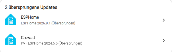

If you use ESPHome, you’ll frequently see notifications for ESPHome updates for the ShineWifi-X, simply because ESPHome is constantly being updated. I’ve been ignoring and skipping these for years, :laughing: so my ShineWifi-X is still running a firmware version from 2023 (2023.3.0). I’ve been ignoring the ESPHome updates - which have now reached version 2026.9.1 - since back in 2024 (2024.5.5).
If you don’t necessarily need or want to use ESPHome, you can flash MQTT firmware onto the stick instead; this allows the inverter data to be sent to an MQTT broker via MQTT. There are various MQTT firmware versions available for this—just search Google for “ShineWifi-X MQTT firmware.”
That said, in my opinion, ESPHome allows you to configure more things (and do so more easily) compared to MQTT firmware. The available MQTT firmware versions aren’t really being actively maintained anymore, though that isn’t necessarily a problem; once the inverter is sending its data to an MQTT broker, there’s really nothing left that needs changing.

I am actually quite happy with the way I get my energy data at the moment. I am aware it depends upon the unusual configuration of the electrical installation in my house (where one of the three phases is not used to power anything), but I can live with that for now.
My real problem was to switch to a new method of measuring and still keep the old data I had collected from Growatt. But now it looks as if the Growatt integration has finally commited suicide:
I can still see all my data from the past year, and Growatt is not coming back each day at noon. Maybe this situation only lasts until HA is restarted again, we will see. For the moment I am counting my blessings.
