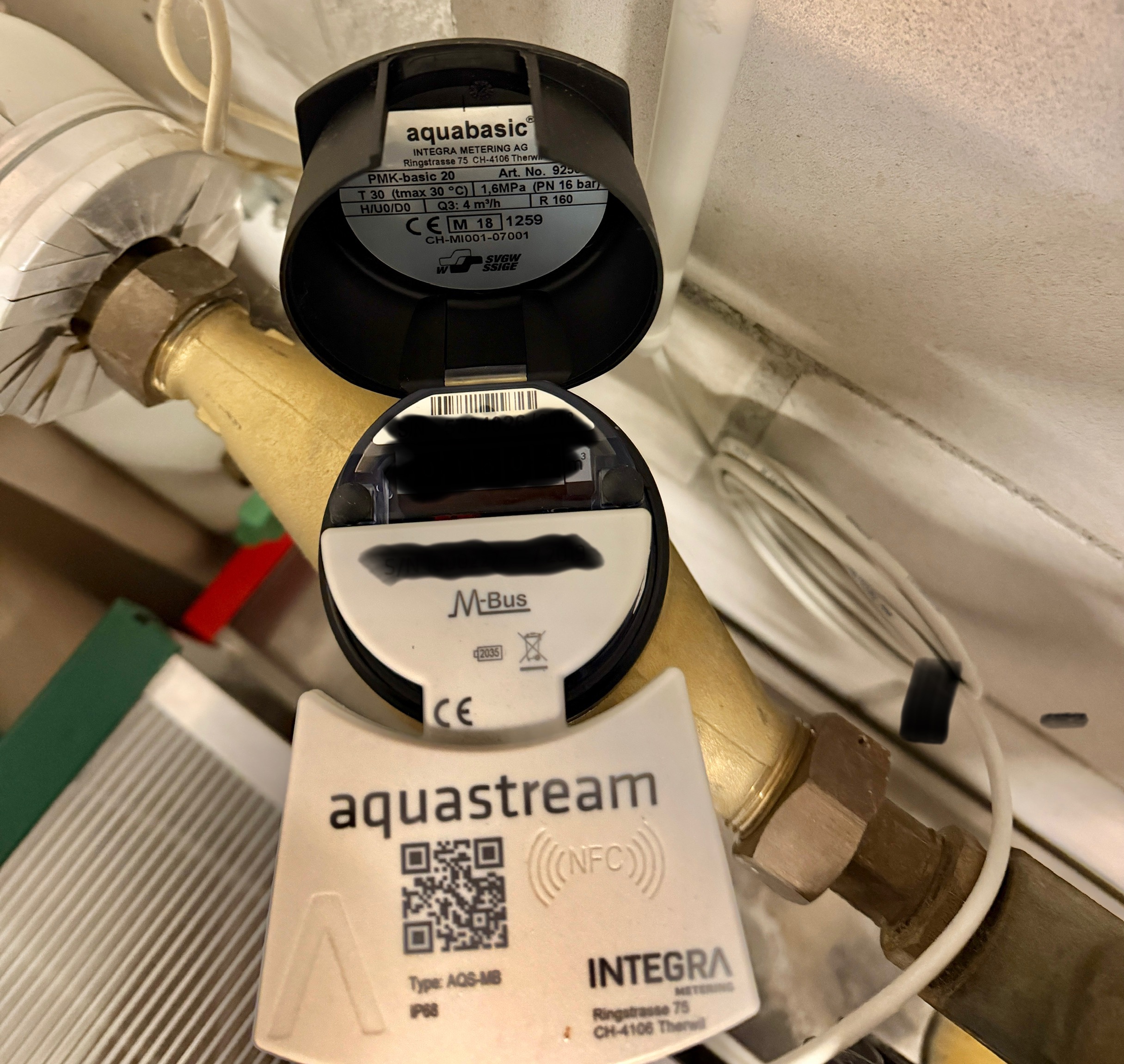

Realy nice ! I’m absolute new in HA, but i want to try it. I’m also in Switzerland/waadt and have a Aquabasic PMK-basic 20, but distance from my HA to meter is big so I’m asking if anybody has already do it with a M-Bus-Ethernet (TCP) converter ? I find that wmbusmeters support funk and wired M-Bus, but I find no info on Ethernet M-Bus ?
Where did you buy your aquastream® M-Bus, direct by Integra ?
Thanks for your Help
Small question, this aquastream ist the m-bus one with cable. You put a usb adapter nano CUL 868 MBUS on your HA (in my case ist a Synology), then you need a conversion from cable to wireless (like a aquaradio® smart M-Bus). I’m right ? Or could I juste by the aquastream® Radio and a CUL 868 MBUS ?
