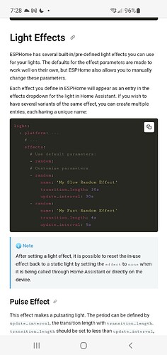

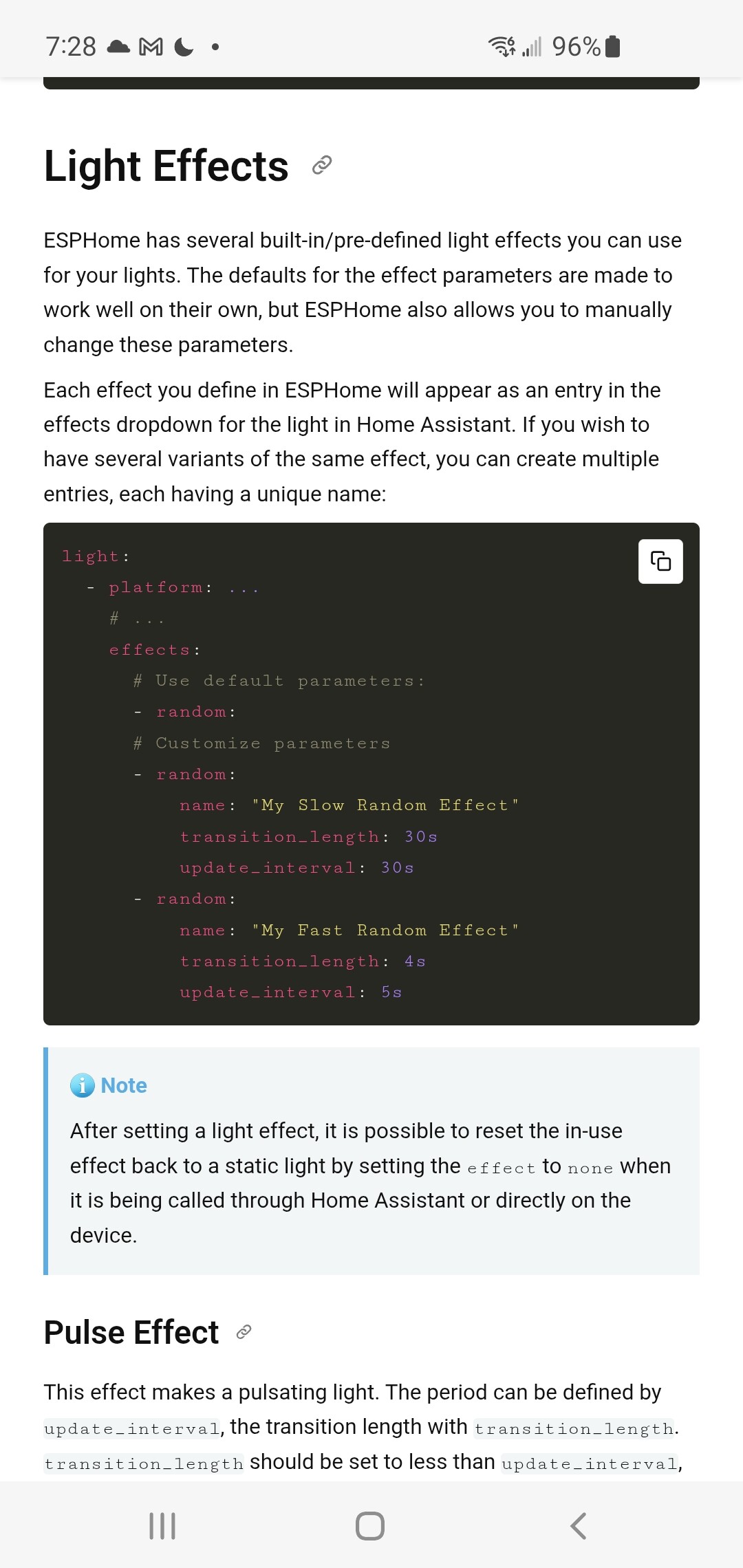

You really should be reading through and using the documentation instead of having AI write a bunch of code that you dont understand and wont understand how to fix it if and when it breaks, plus the Esphome Light platform already has several included light effects to choose from and intuitively use like this “Random” effect right here for example and could have simply been used without needing AI to unnecessarily make a new one for you…
