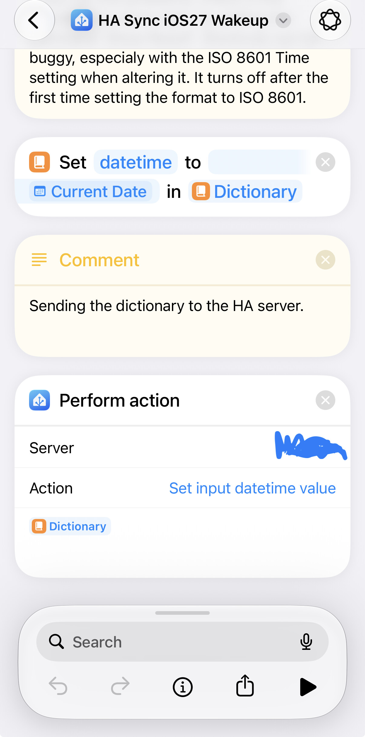

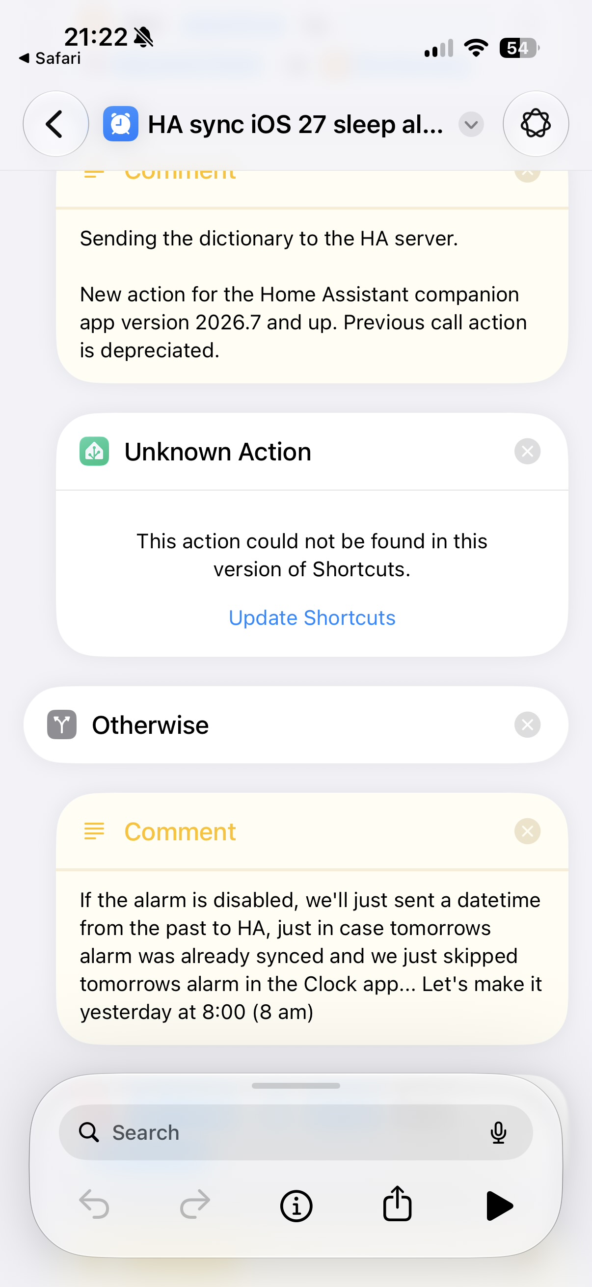

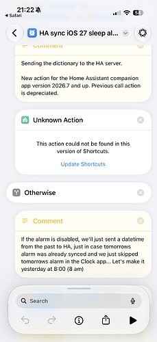

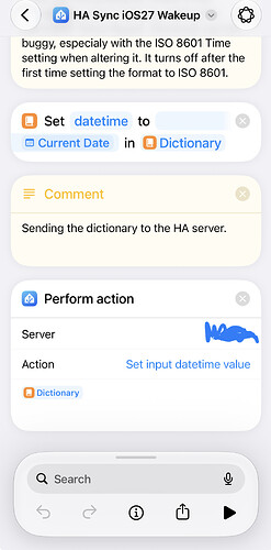

I think it’s broken again
Which version of iOS and companion app are you using?
I’m on iOS 27 beta 4 and companion app 2026.8.0 (2026.2691)
Also on latest iOS27 Dev Beta.
HA App - 2026.8.0 (2026.2691)
Had to remove and re-add the action.
Hard to troubleshoot accurately with beta / testflight releases so expecting it to break a lot.
Probably not stable until prod iOS27 is out.
That error is prompting for an update to shortcuts itself (but there is none) works when manually editing and readding.
What HA action does it use when manually updating?
Both of you are on the developer beta, I’m on the public beta and haven’t experienced this problem. My guess it is both the updated HA app and iOS beta that don’t play nice.
@GTunney If you want to manually (re-)add the action ‘set input date time value’ and add the dictionary (‘woordenboek’) as value:
I can’t even pick a server when creating the action, just get Unknown extension process.
EDIT: Managed to resolve, I had to hard reboot my iPhone, very strange.
