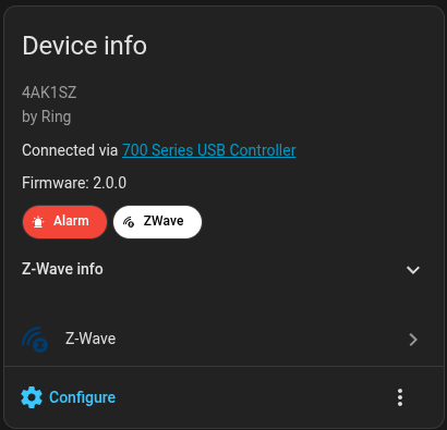

What version of the FW do you have on your device? I’ve recently acquired a second Keypad with 1.20.0 and there seem to be quite a bit of changes compared to 1.18.0. Apparently there is also a version 2.0.0, but only for some hardware versions.
So that’s the weird thing. Supposedly I’m on 2.0.0 but that PR comes from a post where the protocol supposedly got an update. Check this link here and here. That’s why I said it was all quite above my head.
It should also be noted that I have NEVER owned a ring base station so I have no way to update the firmware on this device other than through home assistant. Which from what I’ve read in documentation is almost impossible.
My two devices are on firmware v1.18.0.
I also don’t have any base station so upgrading the firmware seems to be impossible.
