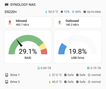

Quite a lot can be pulled from DSm integration. Here is mine:
However there is no single sensor for overal Health status, it would need to be template sensor calculating overal state from individual components health.
Hi, thanks all. That is what I thought. I have made a dashboard based on one I saw on Reddit (here: https://www.reddit.com/r/synology/comments/1gwpq15/home_assistant_synology_integration_dashboard/?sort=new), which has various components coming from the DSM integration, but had hoped I might rely on Synology doing the calculation for me.
PS Mirek, would you be up for sharing your YAML for your integration? It looks really clean and I’m learning to get the hang of dashboards having started again with HA a week or so ago (I gave up with it all about a year ago and sold my HA Green and SkyConnect, but decided to take a second bite of the cherry and bought myself an SLZB06 which is connected directly into my Synology).
Here is the full code for Synology NAS dashboard:

                stat: |-
                    if (states['sensor.synologynas_drive_8_status'].state == 'normal')
                      return 'Normal';
                    else
                      return 'Unsafe';
              card_mod:
                style: |
                  ha-card {
                    background: none;
                    box-shadow: none;
          card_mod:
            style: |
              ha-card {
                background: none;
                box-shadow: none;
      - type: custom:config-template-card
        view_layout:
          grid-area: hdd3
        entities:
          - sensor.esxi_vm_hassio
        card:
          type: custom:vertical-stack-in-card
          horizontal: true
          cards:
            - type: custom:button-card
              icon: mdi:harddisk
              color: >-
                ${states['sensor.synologynas_drive_9_status'].state === 'normal'
                ? 'var(--green1)' : 'var(--red2)'}
              styles:
                grid:
                  - grid-template-areas: "\"i\" \"n\" \"temp\" \"stat\""
                  - grid-template-columns: 1fr
                  - grid-template-rows: min-content min-content min-content
              custom_fields:
                temp: |-
                    return states['sensor.synologynas_drive_9_temperature'].state + '°C';
                stat: |-
                    if (states['sensor.synologynas_drive_9_status'].state == 'normal')
                      return 'Normal';
                    else
                      return 'Unsafe';
              card_mod:
                style: |
                  ha-card {
                    background: none;
                    box-shadow: none;
              icon: mdi:harddisk
              color: >-
                ${states['sensor.synologynas_drive_10_status'].state ===
                'normal' ? 'var(--green1)' : 'var(--red2)'}
              styles:
                grid:
              custom_fields:
                temp: |-
                    return states['sensor.synologynas_drive_10_temperature'].state + '°C';
                stat: |-
                    if (states['sensor.synologynas_drive_10_status'].state == 'normal')
                      return 'Normal';
                    else
                      return 'Unsafe';
              card_mod:
                style: |
                  ha-card {
                    background: none;
                    box-shadow: none;
              icon: mdi:harddisk
              color: >-
                ${states['sensor.synologynas_drive_11_status'].state ===
              styles:
                grid:
              custom_fields:
                temp: |-
                    return states['sensor.synologynas_drive_11_temperature'].state + '°C';
                stat: |-
                    if (states['sensor.synologynas_drive_11_status'].state == 'normal')
                      return 'Normal';
                    else
                      return 'Unsafe';
              card_mod:
                style: |
                  ha-card {
                    background: none;
                    box-shadow: none;
              icon: mdi:harddisk
              color: >-
                ${states['sensor.synologynas_drive_12_status'].state ===
              styles:
                grid:
              custom_fields:
                temp: |-
                    return states['sensor.synologynas_drive_12_temperature'].state + '°C';
                stat: |-
                    if (states['sensor.synologynas_drive_12_status'].state == 'normal')
                      return 'Normal';
                    else
                      return 'Unsafe';
              card_mod:
                style: |
                  ha-card {
                    background: none;
                    box-shadow: none;
          card_mod:
            style: |
              ha-card {
                background: none;
                box-shadow: none;
        view_layout:
          grid-area: status
        entities:
        card:
          horizontal: true
          cards:
            - type: markdown
              content: |
                CPU Temp:
                # {{states('sensor.synologynas_temperature')}} °C
              card_mod:
                style: |
                  ha-card {
                    background: none;
                    box-shadow: none;
            - type: markdown
              content: |
                Uptime: {{states('sensor.synologynas_uptime')}}
                Last Boot: {{states('sensor.synologynas_last_boot')}}
              card_mod:
                style: |
                  ha-card {
                    background: none;
                    box-shadow: none;
            - type: markdown
              content: >
                Installed Version:
                {{state_attr('update.synologynas_dsm_update','installed_version')}}
                Latest Version:
                {{state_attr('update.synologynas_dsm_update','latest_version')}}
              card_mod:
                style: |
                  ha-card {
                    background: none;
                    box-shadow: none;
          card_mod:
            style: |
              ha-card {
                background: none;
                box-shadow: none;
      - type: custom:vertical-stack-in-card
        view_layout:
          grid-area: vol1
        cards:
          - horizontal: true
            cards:
              - type: markdown
                content: >
                  Volume 1  ({{
                  ((states('sensor.synologynas_volume_1_total_size') | float() -
                  states('sensor.synologynas_volume_1_used_space') | float()) *
                  1024) | round(2)}}GB free)
              - type: markdown
                content: >
                  Volume 2 ({{
                  ((states('sensor.synologynas_volume_2_total_size') | float() -
                  states('sensor.synologynas_volume_2_used_space') | float()) *
          - horizontal: true
            cards:
              - type: custom:custom-features-card
                features:
                  - type: custom:service-call
                    entries:
                      - type: slider
                        entity_id: sensor.synologynas_volume_1_volume_used
                        tap_action:
                          action: perform-action
                          data: {}
                        range:
                          - 0
                          - 100
                        autofill_entity_id: true
                        unit_of_measurement: GB
                        ticks: false
                        thumb: flat
                        styles: |-
                          :host {
                            --color: var(--orange1);
                            height: 15px;
                features:
                    entries:
                      - type: slider
                        tap_action:
                          data: {}
                        range:
                          - 0
                          - 100
                        ticks: false
                        thumb: flat
                        styles: |-
                          :host {
                            --color: var(--magenta1);
                            height: 15px;
        view_layout:
          grid-area: charts1
        entities:
        card:
          type: custom:history-explorer-card
          refresh:
            interval: 5
          defaultTimeRange: 4h
          showUnavailable: false
          uimode: dark
          uiColors:
            gridlines: "#444856"
            labels: "#A4A7B4"
            buttons: "#2C2E3C"
            selector: "#2C2E3C"
            closeButton: "#0000001f"
          labelAreaWidth: 50
          labelsVisible: false
          uiLayout:
            selector: hide
            toolbar: hide
          header: hide
          graphs:
            - type: line
              entities:
                - entity: sensor.synologynas_cpu_load_total
                  color: "#aaaaaa"
                  fill: "#aaaaaa22"
                - entity: sensor.synologynas_cpu_load_system
                  color: "#E61116"
                  fill: "#E6111622"
                - entity: sensor.synologynas_cpu_load_user
                  color: "#003C9E"
                  fill: "#003C9E22"
            - type: line
              entities:
                - entity: sensor.synologynas_network_down
                  color: "#F5A624"
                  fill: "#F5A62422"
                  scale: 0.001
                - entity: sensor.synologynas_network_up
                  color: "#6A34E0"
                  fill: "#6A34E022"
                  scale: -0.001
          card_mod:
            style: |
              ha-card {
                background: none;
                box-shadow: none;
        view_layout:
          grid-area: charts2
        entities:
        card:
          type: custom:apexcharts-card
          header:
            show: false
          chart_type: donut
          series:
            - entity: sensor.share_size_0
              color: var(--green1)
            - entity: sensor.share_size_1
              color: var(--lemon1)
            - entity: sensor.share_size_2
              color: var(--yellow1)
            - entity: sensor.share_size_3
            - entity: sensor.share_size_4
              color: var(--red1)
            - entity: sensor.share_size_5
              color: var(--pink1)
            - entity: sensor.share_size_6
            - entity: sensor.share_size_7
              color: var(--darkblue1)
            - entity: sensor.share_size_8
              color: var(--lightblue1)
            - entity: sensor.share_size_9
              color: var(--cyan1)
            - entity: sensor.share_size_10
              color: var(--green3)
            - entity: sensor.share_size_11
              color: var(--lemon3)
            - entity: sensor.share_size_12
              color: var(--yellow3)
            - entity: sensor.share_free_space
              color: var(--dark-text)
          apex_config:
            legend:
              position: bottom
            chart:
              height: 400
          card_mod:
            style: |
              ha-card {
                background: none;
                box-shadow: none;
      - type: custom:text-divider-row
        view_layout:
          grid-area: controls
        text: Synology NAS
        view_layout:
          grid-area: drives
        text: Hard Drives
        view_layout:
          grid-area: sysstats
        text: System Status
        view_layout:
          grid-area: volumes
        text: Volumes
        view_layout:
          grid-area: graphs
        text: System Usage
Please note that it also include some statistics about storage consumption, that are a bit tricky to obtain (I use python script run periodically on NAS, that creates JSON file based on which sensors used by apex chart are created). Also some code for dashboard is duplicated - I use media query to display various versions depending on screen size (desktop vs. mobile).
So full dashboard looks following:
Amazing, thank you!!
