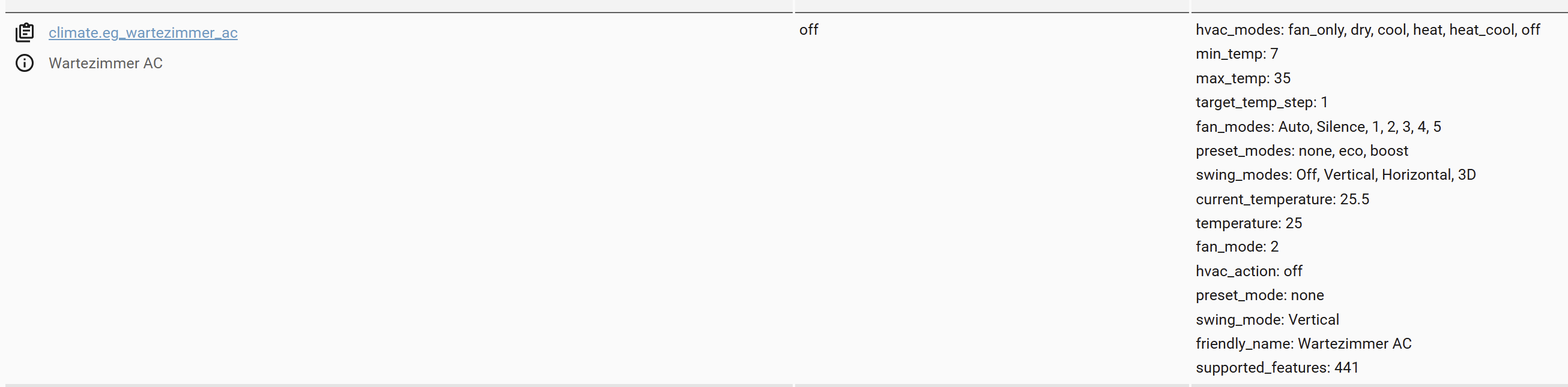

I checked the current state of my device with development tools and it shows 'fan_only' but execution stops.
Whats going on here?. The content of 'myAcDevice' is ok, because I can see that everything in my blueprint works fine.

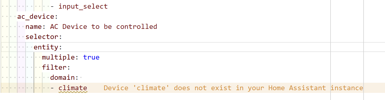

BUT: Asking me, that in the variable it needs an 'climate' device triggers more investigation. Whenever I used the variable in my blueprint to carry out some action, the AC box do it. For me: "Content of this variable correct". But the Studio server shows some message which I ignored (as somebody told me, that this messages were not reliable):slight_smile:
I immediately checked the configuration.yaml and there is the 'climate-line'.

    ac_device:
      name: AC Device to be controlled
      selector:
        entity:
          multiple: true
          filter:
            domain:
            - climate

And here is the AC box as Home Assistant development tools see it:
There is a valid state. No error no problems reported.
It's an aged custom integration with quite a few issues so there may be issues attributed to HA updates.
I'll take a look at the source code.
Ok, is there better PID thermostates around? Havn't found other solution than that.
And: Why is the AC box automation ok and the blueprint made out of this automation not? Did a blueprint use a total different code base doing the automation tasks?
Sorry, still a newbee.
Based on your shared image, your PID thermostat is fine. It's a coding issue

Edit, Nevermind. I see you posted the full automation above. Your problem is the variable and potentially the way you're testing it.
Your selector is marked as an entity selector with multiple: true
This means you'll be getting a list or a single entity back and you need to account for that.
  _myAcDevice:          !input ac_device
  myAcDevice: "{{ [_myAcDevice] if _myAcDevice is string else _myAcDevice }}"
