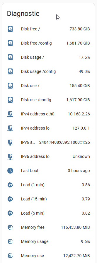

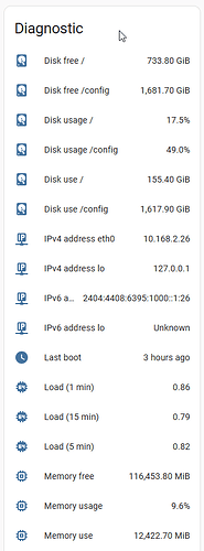

Based on your question, I added the integration, enabled all the sensors and it the majority of them seems to work in my docker setup.
Although some of the info is based on the underlying server and not what’s been allocated to the container i.e. memory - I’ve allocated a 4Gb to the container but the integration is showing the server memory of 128Gb
Same goes for Load averages, that is for the server and not the container.
IP Addresses and packets per-interface is for the container
So there are a few little things, all depending on the reason why and use cases you are looking to get it.
Awesome! Appreciate the screenshot. Tells me exactly what I am looking for.
