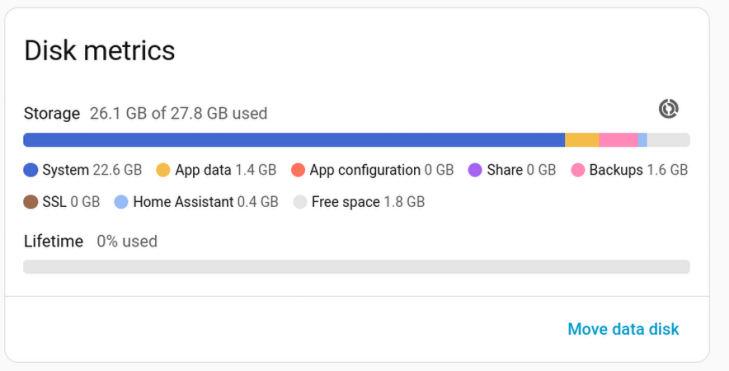

The System is giving me warnings that it is running out of storage. But almost all of the space is taken up by the system (22 out of 28gb) and i cannot clear that.
Any ideas on how to clear this? i can’t imagine that out of hte box its using such a large % of the
disk for system resources. I have followed some guides on how to do it by using docker etc and clearing cache etc but this hasn’t fixed the issue.

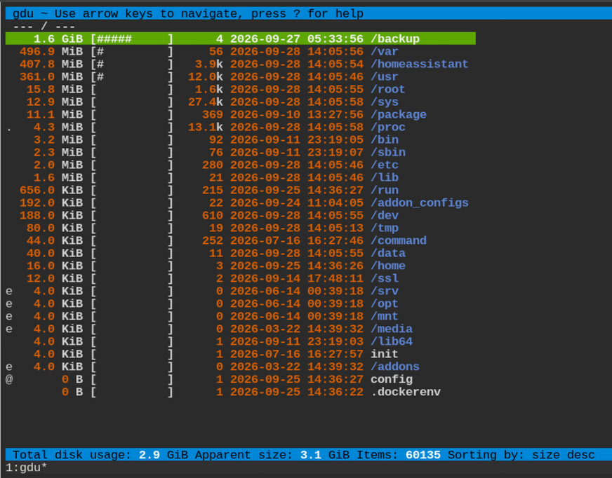

Have run that script.
It says i am using 2.9GB for the system
Not sure where the other 20gb of consumed space is coming from…
Did you check the storage space taken by your backups as advised by Sir_Goodenough?
Please read the whole article, especially the background and the bloat sections. That is NOT the system. Use the Full access to files section.
You can see that in the first picture as well as here
Wait - wouldn’t the backup in pink (1.6GB), so outside of system in blue (22.6GB)…?
Yep. That’s what I was referring to with the first picture.
