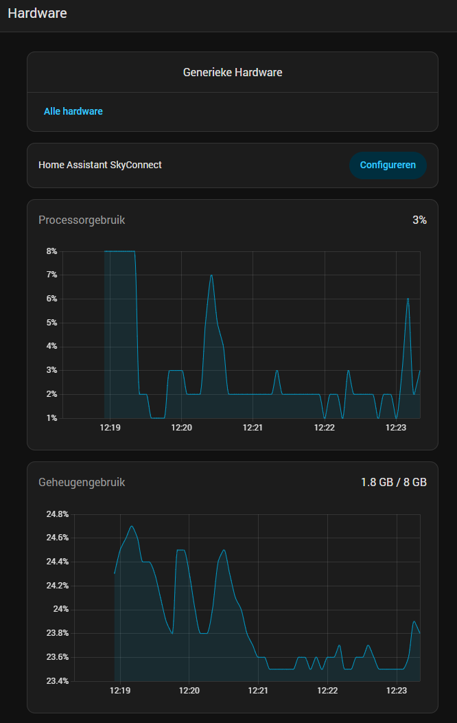

System unresponsive when building a device in 2025.8.1
The whole system becomes unresponsive when building my ESP devices, from simple to more complex devices with external components.
Need to restart the complete VM, don’t experience any other issues.
The supervisor (TrueNAS) has enough memory, the full 8GB is allocated as minimum memory size.

Hardware info:
System log does not show anything related.
All advice is welcome.

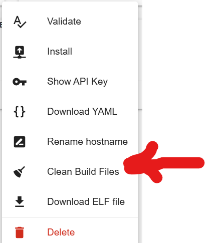

same here, but me Dashbaord is running outside of HA as a PVE LXC container. One other thing worth notice is at every attempt some disk space is wasted. So far I’ve lost 12Gb trying to get this node to build.
Try this:
