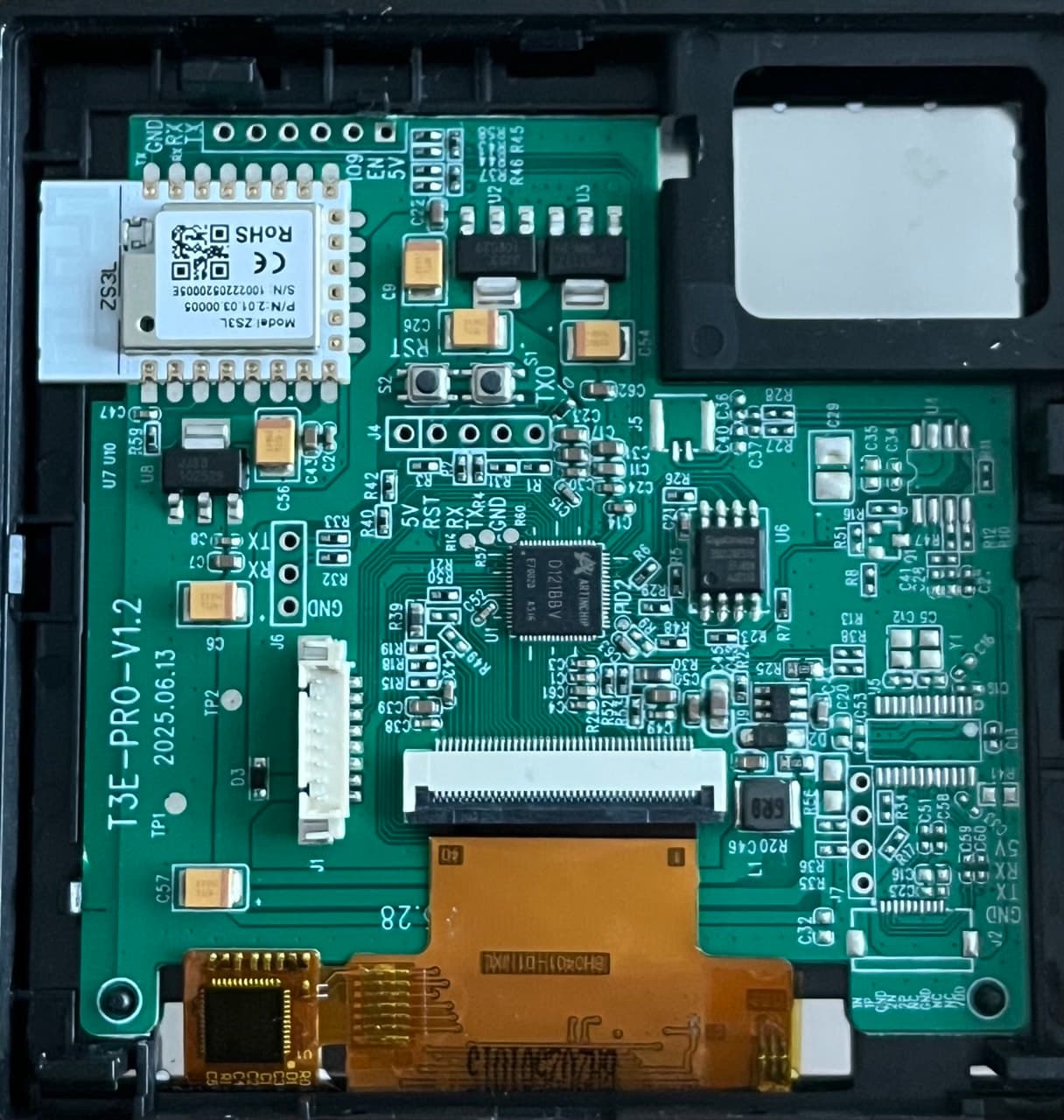

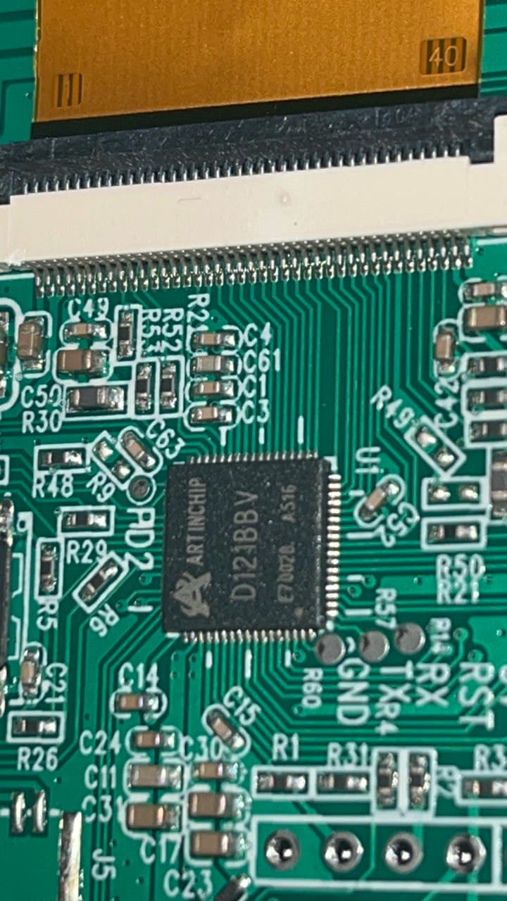

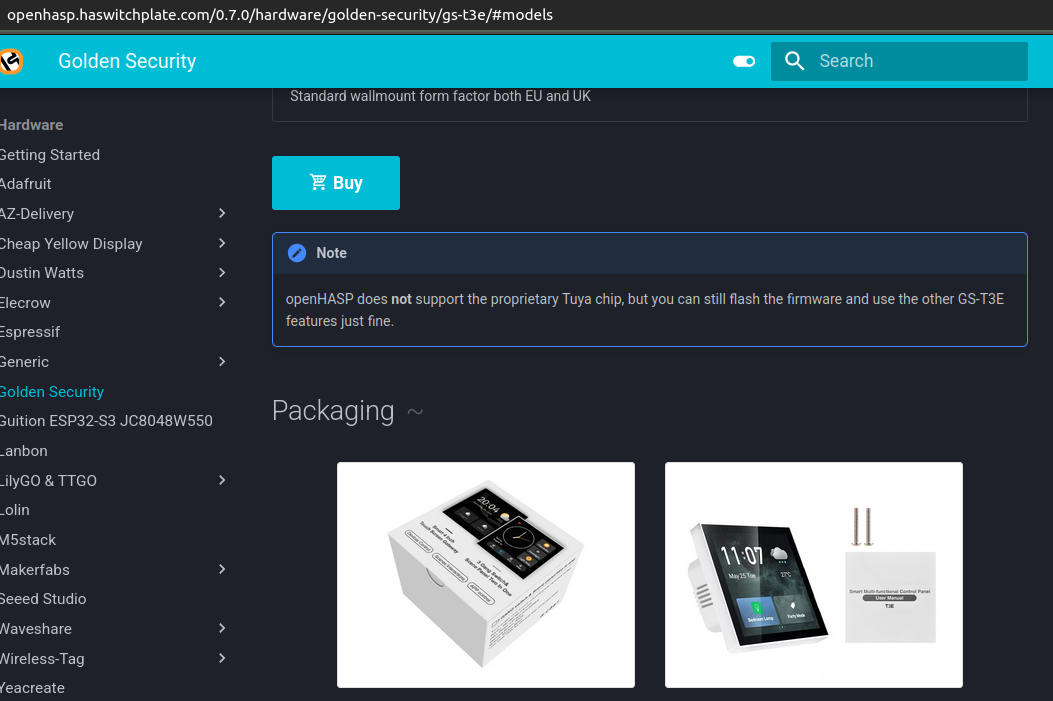

I bought a T3E display without buttons. I was under the impression that I could flash OpenHASP (or something similar) onto it. There’s an explanation for this here: https://www.openhasp.com/0.7.0/hardware/golden-security/gs-t3e/. But before I hit flash, it seems to me that this device doesn’t have an ESP32 chip in it.

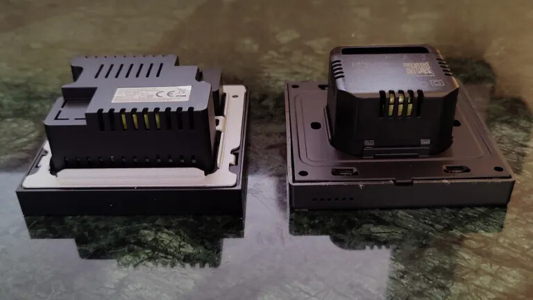

Next to both chips, there’s a JTAG connector to communicate with and possibly flash the device.

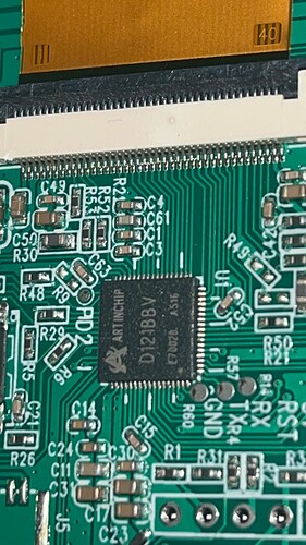

I suspect that the D121BBV is the CPU for rendering the GUI on the display, but I’m not sure.
Does anyone have experience with this, or is this something I can’t use?

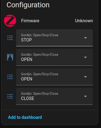

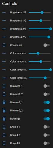

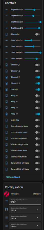

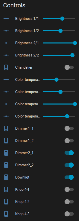

By the way, Home Assistant detects the Zigbee device (without additional sensors), but I would of course like to configure the buttons on the display myself and have that handled through Home Assistant.
Type: T3E-PRO-V1.2
CPU: D121BBV
Zigbee: ZS3L

Seems the only thing in common with the openhasp device you mention is the name…

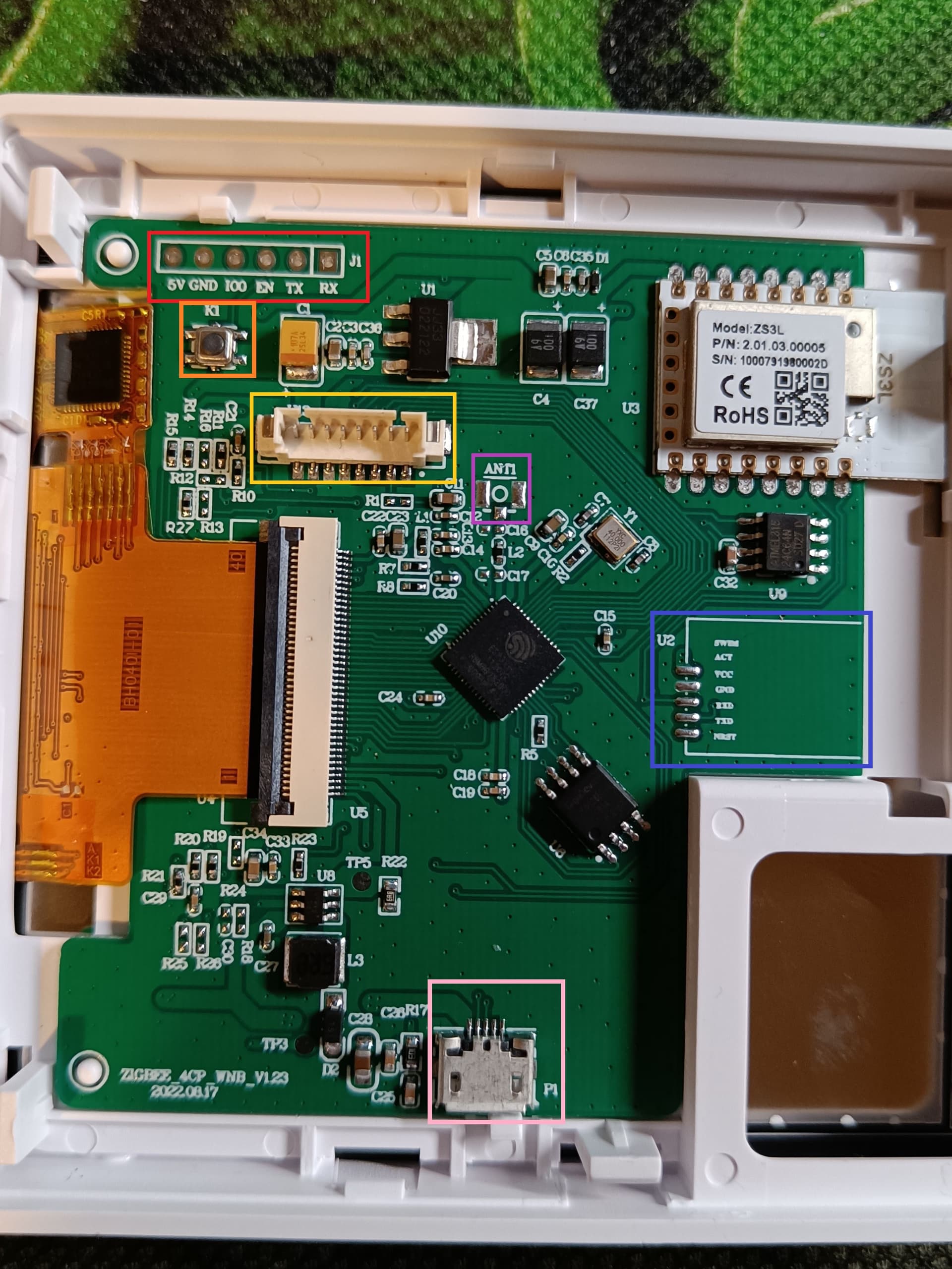

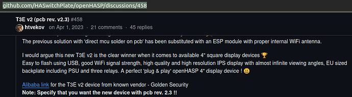

Yes, and based on a tip that it would be the same as this device https://www.thesmarthomebook.com/2022/09/30/sonoff-cam-slim-and-the-nspanel-pro/
and this GS-T3E v1 - DISCONTINUED PRODUCT !!
The casing looks the same, but the print is slightly different. So apparently it’s a few euros cheaper, but without the ESP and I don’t think it’s usable :frowning:

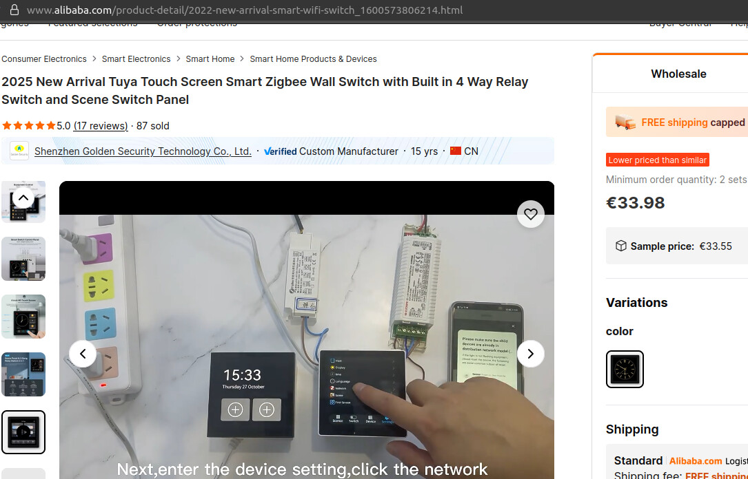

https://www.alibaba.com/product-detail/2022-new-arrival-smart-wifi-switch_1600573806214.html?spm=a2700.details.0.0.252d69cf8GeWdp
And also:
Buy redirects to:

Have you received the pro version by buying the non pro version on your link ?
I was about to buy exactly the same and I suspect them to send the pro version that seems not based on esp anymore …
