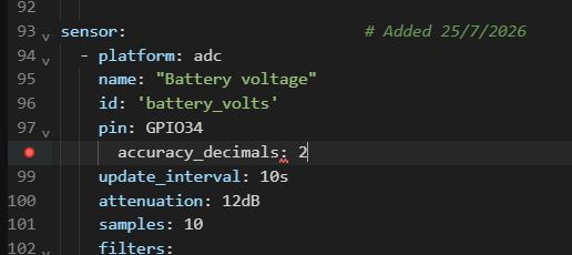

In the device editor screen, if the cursor is at the end of a line, (far right) and the tab key is pressed, the whole line moves to the right. Not just the cursor.
Why is that?
Cursor at the end of line 98.
After tab key pressed.

Do not use tabs in YAML. Tabs are strictly not allowed in YAML so the developer is free to use the key for other things as they see fit in the editor.
