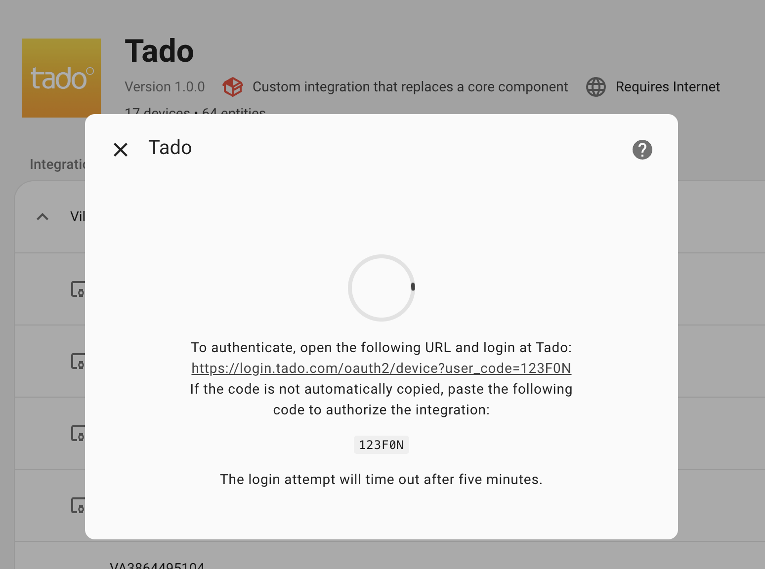

Custom components require translation files to be added manually.
They are not in @dmho s repo, because these files are generated for core components.
That’s why the dialogs with the URL and verification codes are empty, when you click on Reconfigure.
Quick fix: Copy custom_components/tado/strings.json to custom_components/tado/translations/en.json.

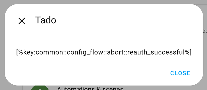

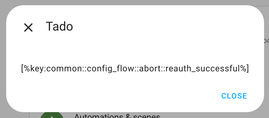

[%key:common::config_flow::abort::reauth_successful%]
and then
Failed to set up: Device login flow status is PENDING. Starting re-authentication.

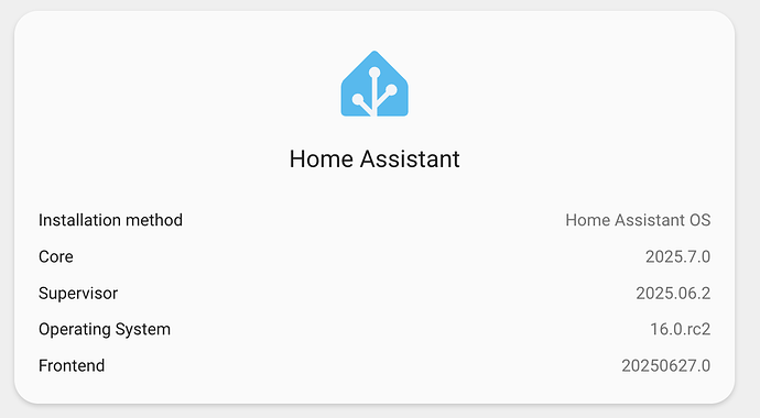

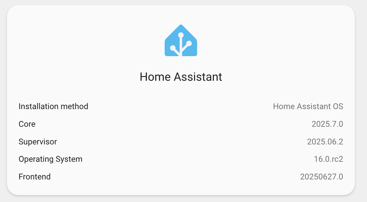

@virusczz @JDaniel, I went through the same trouble today and fixed it as it was mentioned in other posts before. In the manifest.json file, you have to add a new line stating the version of HA. Like this: “version”: “2025.5.2”. You can get your version inside the about tab in HA.
I don’t think that’s the issue in this case. The version field is mandatory in the manifest.json. You know it works because HA display an icon along with “Overwrited by custom integration”, otherwise it won’t load the integration at all. As far as I know, the value of that field is not relevant.

Thank you very much, that did work out! You need to do a force reload of the frontend though (e.g. Cmd+Shift+R on Firefox/Mac). The link/code message shows properly now. Only thing still not working is the confirmation message, but that isn’t that important anyway (I suspect that is because custom integrations cannot use the common core integration strings).
