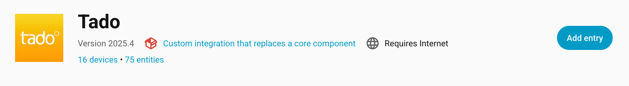

Then, your last step is to restart your HA instance. After that, you should see a ā€œred boxā€ icon on the tado integration, like this:
Open your Home Assistant instance and show an integration.
Hi Karl, I’ve tried to install the integration as you said here but i don’t get the red box and I don’t know what I’m doing wrong…

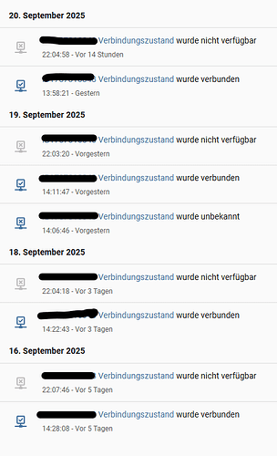

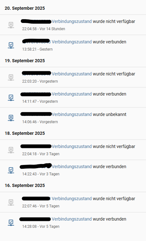

I have the same problem since a few days. First time I noticed it was last Tuesday (September 16). At around 10pm my Tado integration lost connection the first time. I first thought it was due to the new limit off 100 API calls per day, so the next morning I subscribed for the Auto Assist Feature to get at least 20.000 API calls a day. A few hours later, at around 2 pm, it suddenly worked again - so I thought everything worked fine again now. But same day again at araound 10pm like the day before, the Tado integration was unavailable again. And it went on like that … Thursday at around 2pm Tado was back but again at around 10pm unavailable ??? So probably today it will be back again the next 4 hours … Something is definitely strange. I use a bridge and 7 radiators. So if I would be over the limit off 20.000 API Calls, I would expect to reset the limit with beginning of the new day and not at around 2 pm? Anyone else having those problems? For me, the question is now if I can live with the HomeKit integration or if I should change to another system -maybe Eve or Bosch (the Matter versions). What do you guys think?
I’ve had the problem recur yet again today and once more I’m locked out. It won’t reauthenticate even though the link to Tado says it has successfully connected.
I do have the auto assist subscription, so should not have been timed out (or if I have, the limit is totally unrealistic).
Getting very frustrated with this–I was about to buy a second Tado installation for another house, but that is on hold if this can’t be fixed.
Are you able to reauthenticate after it drops out, or does that rarely work (as in my situation)?
Since Tuesday nothing changed. Every day at around 10pm Home Assistant Tado integration looses connection. At around 2 pm the next day, so around 16 hours later, it automatically reconnects. Whe I restart HA before, I get an error message and I need to reauth manually but that’s only possible after 2 pm.
I talked to Tado support and they told me they have no official HA support but what I described loks for them I would be above the 20.000 limit. For me, that sounds very strange. I f I would be over that limit, I would expect the limit to be restet with the beginning of the new day and not at 2pm.
