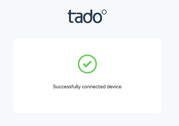

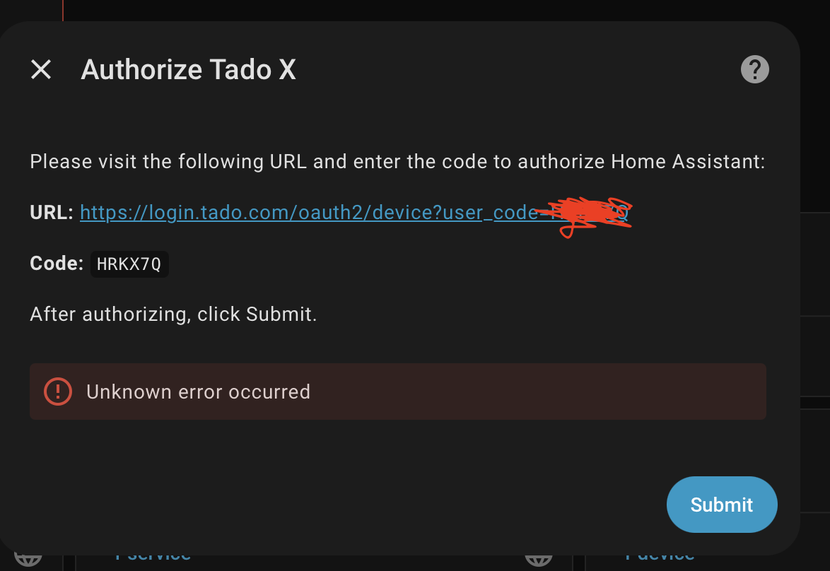

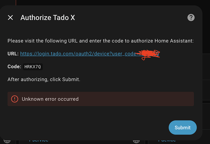

For some reason the manually patched old version stopped working this evening, I installed your Tado X version, however I’m running into issues:
Connecting was successful
However in HA I get this:
Any ideas?
EDIT:
Logs gave it away…
custom_components.tado_x.api.TadoXRateLimitError: API rate limit exceeded (429). Please wait for quota reset.
