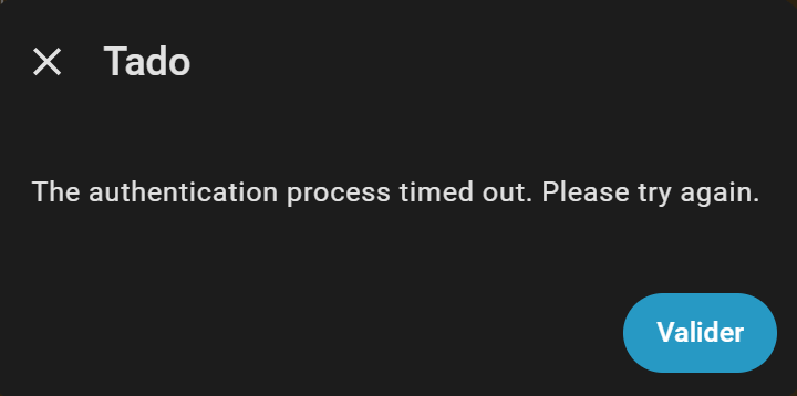

Today the Tado integration requested for a re-authentication but there are no way to complete the process.
Everything work in the same way:
  • Tado generate a code with a link for the logon
  • In the Tado website accept the access
  • The Tado website respond successfully
  • Back in the HA Tado integration configuration banner and it report the error “The authentication process timed out. Please try again.”
I tried to:
  • Re-try the auth process (no way, same error every time)
  • Restart HA and re-try the auth process (no way, same error every time)
  • Reboot the entire HA system and re-try the auth process (no way, same error every time)
  • Removed the Tado integration and the rebooted HA system and re-tried the auth process (no way, same error every time)

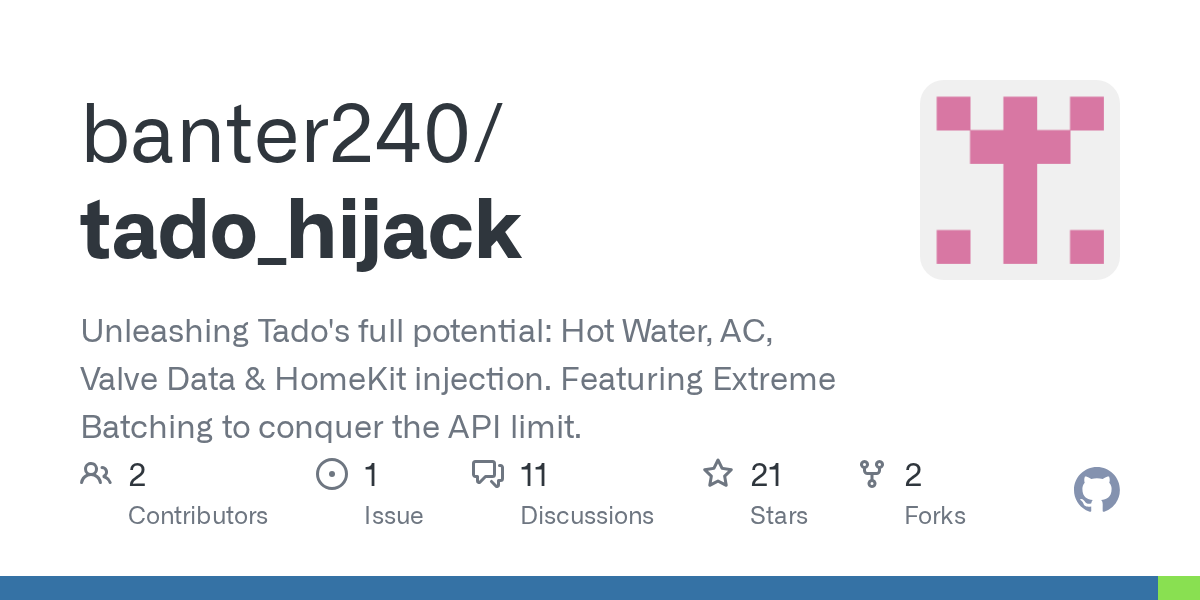

OR
You could try this new custom component that’s recently been created:
