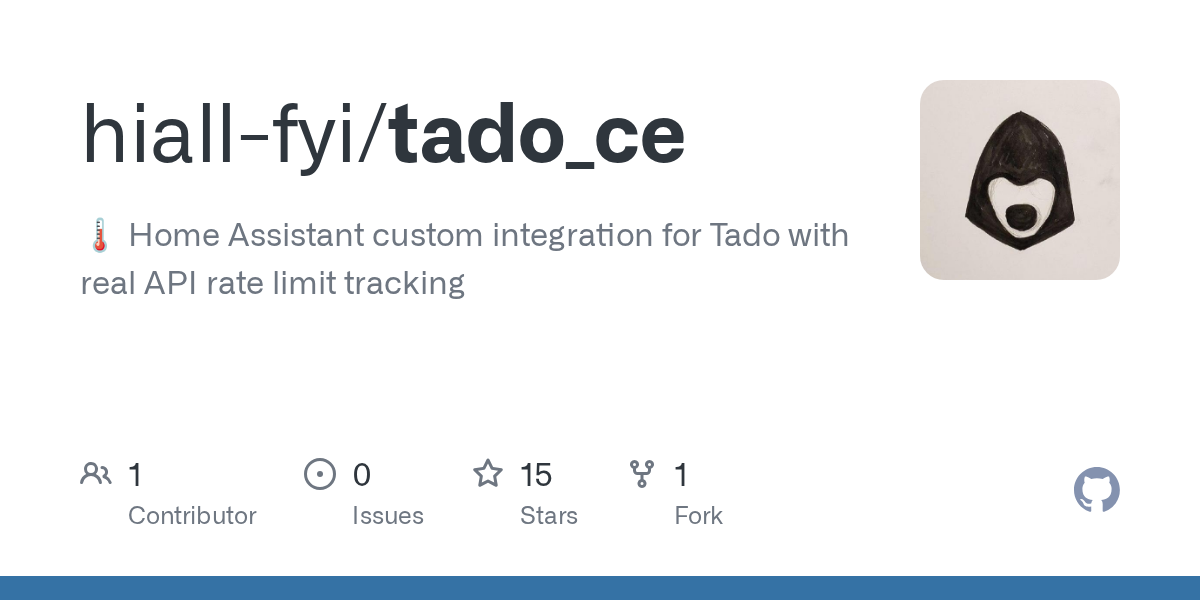

Tado CE integration looks very interesting:
As written on Gitbub by the maker (Hiall-fyi):
Tado CE takes a different approach - we use Tado’s batch endpoints:
  • zoneStates - Gets ALL zones in 1 call (temperature, humidity, heating power, etc.)
  • weather - 1 call
  • zones + mobileDevices - 2 more calls (only every 6 hours)
So regardless of how many devices you have, it’s just 2 calls per quick sync or 4 calls per full sync.
With 100 calls/day:
  • Quick sync every 30 min (day) / 2 hours (night)
  • ~80 calls total, leaving 20% buffer
With 5,000 calls/day:
  • Quick sync every 10 min (day) / 30 min (night)
  • ~240 calls total
It automatically detects your limit from Tado’s response headers and adjusts polling accordingly.
I disabled polling for my TADO integration, so this afternoon, i Should be able to try Tado CE. I like the way it should work with the (stupidly low) 100 API call limit.
