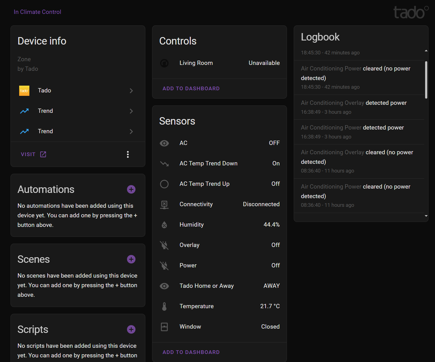

Another strange one with TADO.
All sensors showing except the thermostat.
  • No Re-Authentication showing and seems connected
  • Refreshed Browser
  • Reloaded Integration
  • Restarted HA
  • Rebooted Host
  • Still No Thermostat shown
