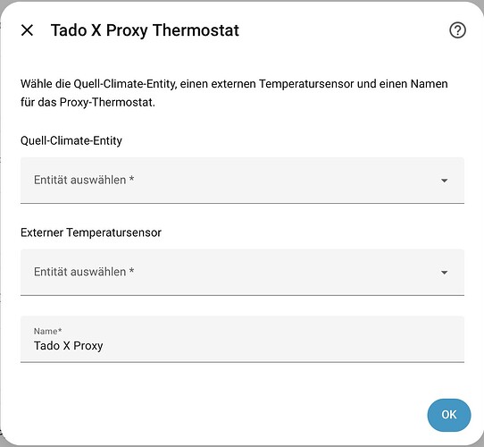

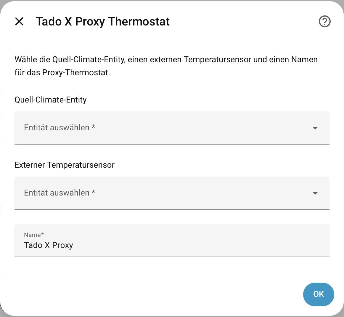

  • the configuration flow, including the required inputs: source climate entity, external temperature sensor, and proxy name

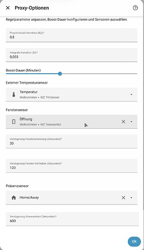

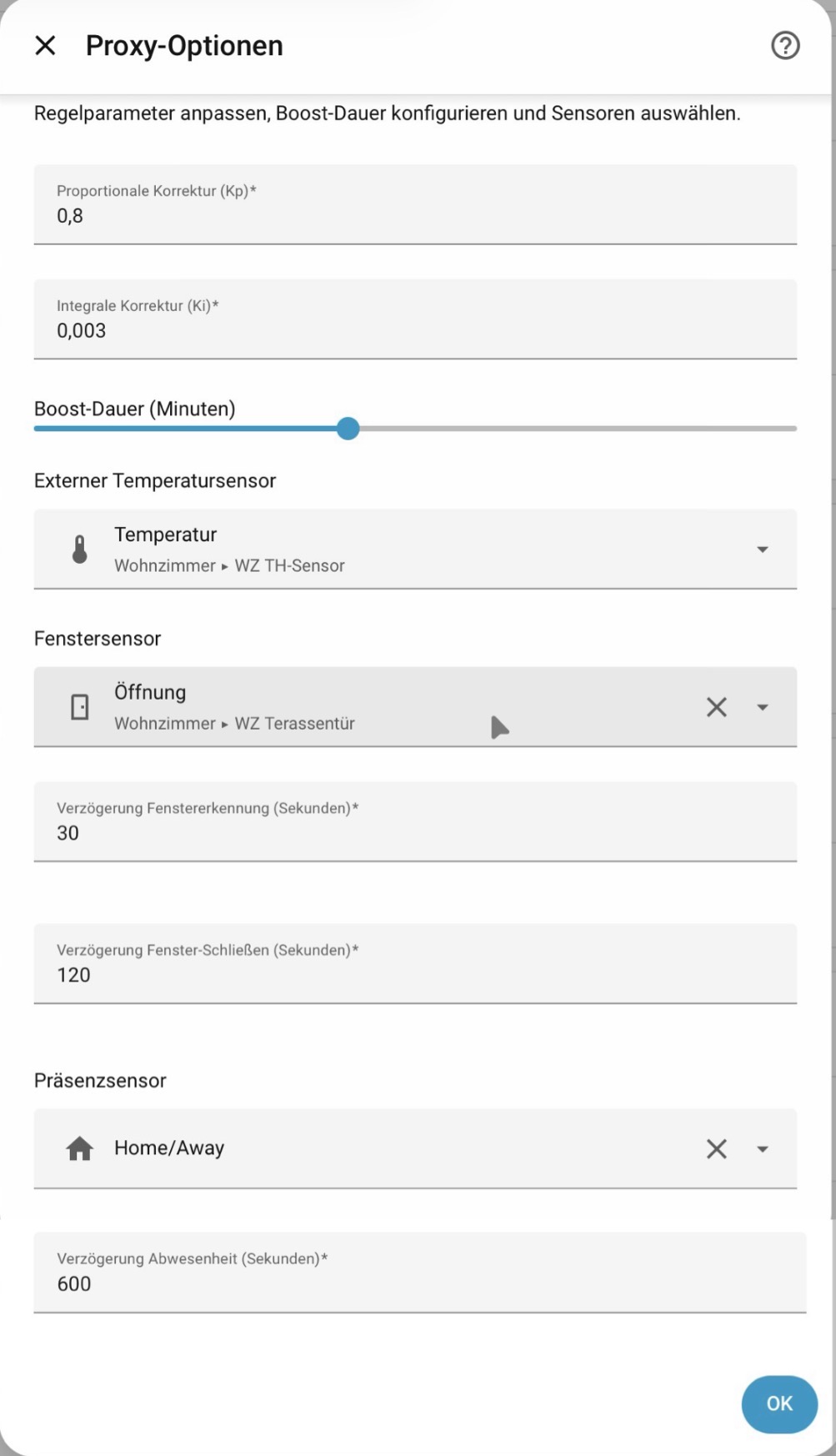

  • the options dialog, where you can adjust the proportional and integral correction, configure the boost duration, select the remote sensor, window sensor, and presence sensor, and define the various delays

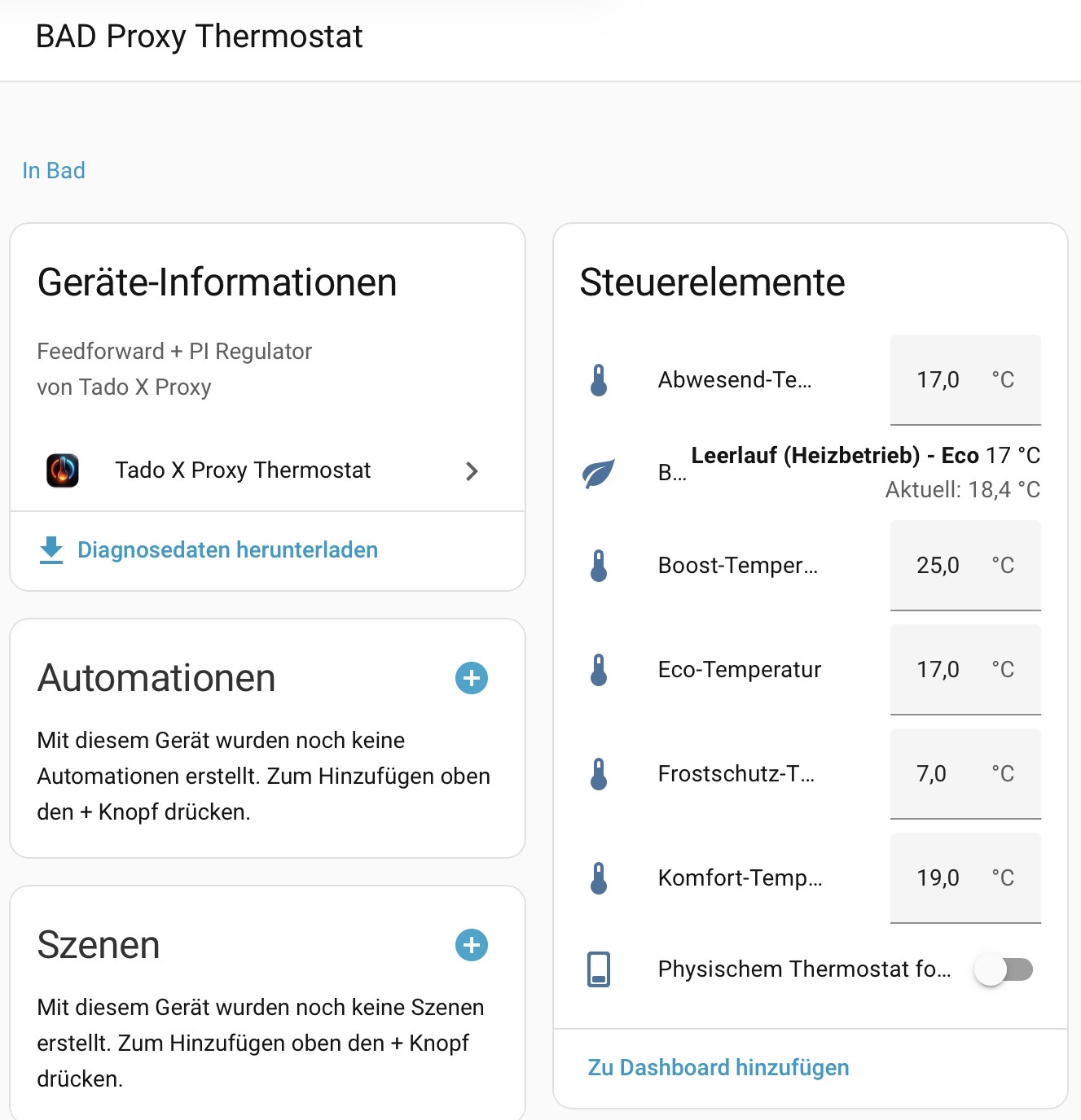

  • the device page, where preset temperatures can be adjusted per room and where the Follow physical thermostat switch is available

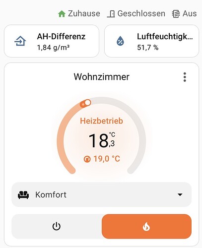

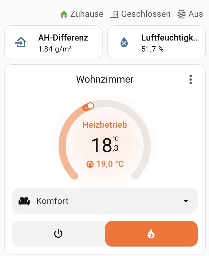

In the dashboard screenshot, I use several badges at the top to indicate key states at a glance — for example whether I’m home, whether the living room window is closed, and whether my ventilation recommendation is currently active.
I also use one card to display humidity from the external sensor and another to show the absolute humidity difference between indoor and outdoor air. This makes it easier to judge whether ventilating the room would actually help with dehumidification.
The thermostat card itself shows the current temperature, target temperature, active preset, and heating state.

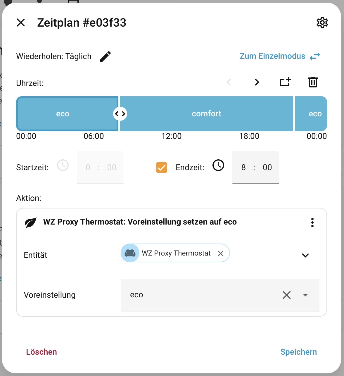

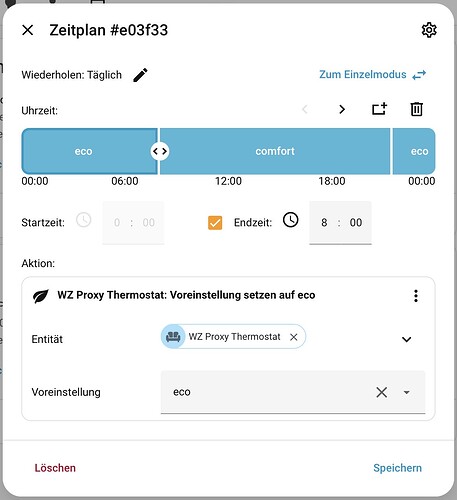

Example Schedule
I’m also using the proxy thermostat together with Scheduler. For example, the living room follows a simple schedule:
  • Eco from 00:00 to 08:00
  • Comfort from 08:00 to 22:00
  • then back to Eco
This setup works very well with the proxy thermostat.

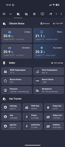

This look really nice! So you’re running tado x fully local, everything working, and your proxy on top? Scheduling with scheduler-card and no API limitations?
Wow, I’m really sold!!!
What are your HA tbrs?
I use a slbz-mr3u dual for z2m and otbr, working nicely. I migrated from a dirigera hub, removed all other 3rd party cloud integrations, only tado remained.
I have a wireless receiver x - wired to my viessmann vitodens opentherm combi boiler, a bridge x, 2 wireless temp sensor x and 6 x trv valve thermostats x.
And why do you keep the bridge x? As a repeater for your HA thread mesh?
I’m not too advanced, my only fear for migrating from tado to ha thread mesh is that I might get stuck somehow and freeze. My wife would kill me :slight_smile:
So I will wait sunnier days to fully migrate, anyway it seems soo nice, your project. I often get sign out errors with tado x integration, though it shows I have 1000 api calls and would usually get about 2-300 daily.
Thanks for your work, I will watch it closely and report my experience.

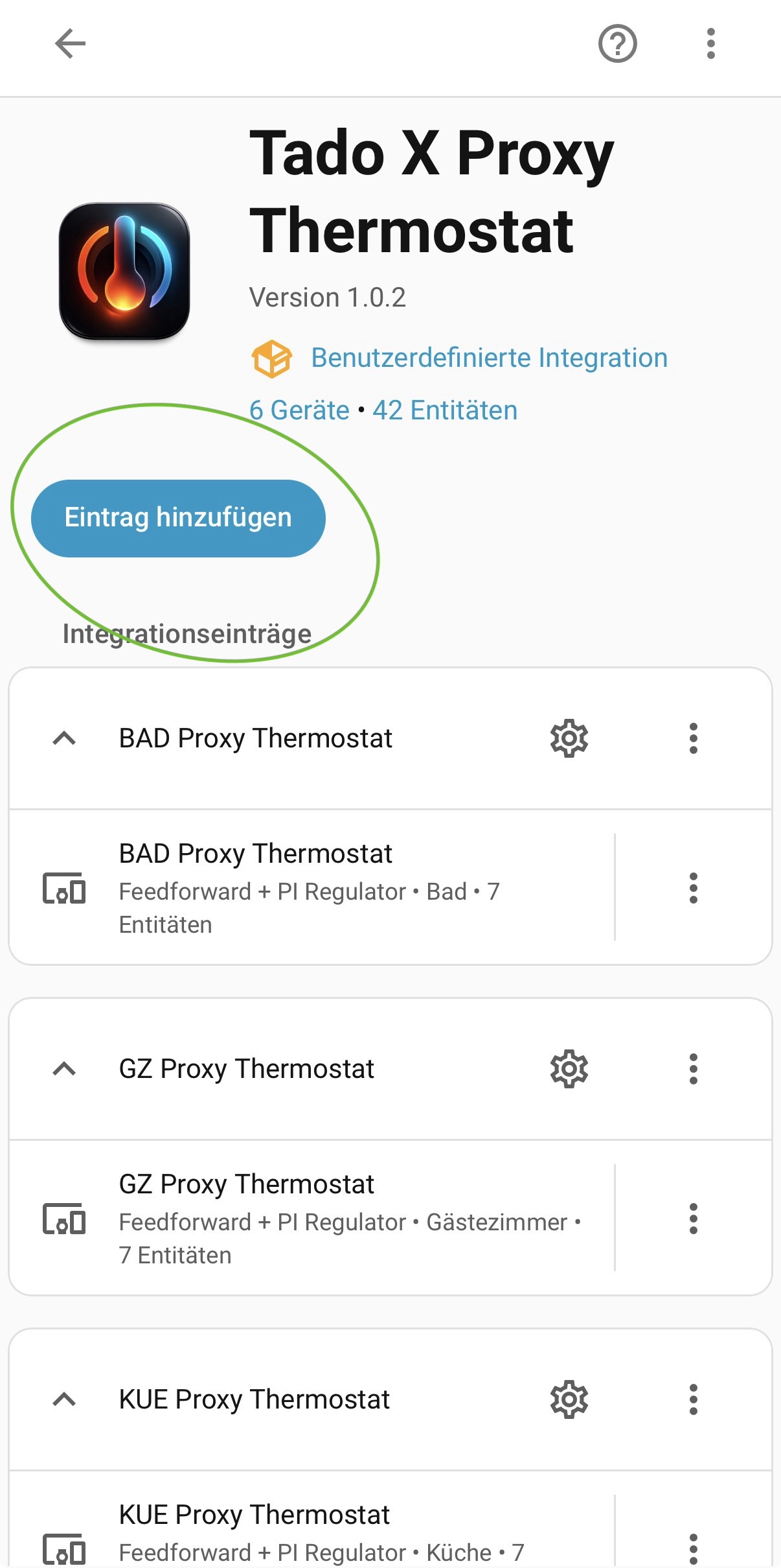

So I added the integration via hacs. Is it to my understanding I need to add as many integrations as rooms I need?
I renamed climate.tado_x_proxy to climate.proxy_bucatarie for the first room. So I need to add the next ones, right? To keep things tidy with my automations I will add also for the rooms I have wireless temp x devices next to the trvs, even though the coordinators are the wireless temp x.
Also, for my pause automation’s save logic, does climate.tado_x_proxy expose manual_control_active and temperature attributes the same way the underlying Tado entity does?
Thank you!
Right, you add the integration and then add one entry for each room:

        value: "{{ states(climate_entity) }}"
    - service: input_text.set_value
        entity_id: "{{ prev_preset }}"
        value: "{{ state_attr(climate_entity, 'preset_mode') or 'eco' }}"
        entity_id: "{{ prev_temp }}"
        value: >-
          {% set t = state_attr(climate_entity, 'temperature') %}
          {{ t | string if t != None else '18' }}
    # Save manual state — "true:<temp>" if preset is none (manual drag), "false" otherwise
        entity_id: "{{ prev_manual }}"
        value: >-
          {% set preset = state_attr(climate_entity, 'preset_mode') %}
          {% if preset == None or preset == 'none' %}true:{{ t | string }}{% else %}false{% endif %}
    - service: climate.set_hvac_mode
        entity_id: "{{ climate_entity }}"
        hvac_mode: "off"
    # Also turn off underlying Tado entity directly
    # Needed because proxy sends 5°C min instead of true off
        entity_id: "climate.{{ room }}"
        hvac_mode: "off"
        entity_id: "{{ pause_reason }}"
        value: >-
          {% set sensors = area_entities(room)
            | select('match', 'binary_sensor.*(window|door).*')
            | list %}
          {% set window_open = sensors
            | select('search', 'window')
            | select('is_state', 'on')
            | list | count > 0 %}
          {% set door_open = sensors
            | select('search', 'door')
            | list | count > 0 %}
          {% if window_open and door_open %}Window & Door Open{% elif window_open %}Window Open{% elif door_open %}Door Open{% else %}Opening Detected{% endif %}
- id: universal_heating_restore_sweep
  alias: Heating - Restore Sweep
  mode: parallel
  triggers:
    - trigger: state
      entity_id:
        - binary_sensor.window_sensor_birou_ls
        - binary_sensor.window_sensor_birou_rs
        - binary_sensor.window_sensor_dormitor
        - binary_sensor.window_sensor_living
        - binary_sensor.window_sensor_bucatarie
        - binary_sensor.door_sensor_bucatarie
      to: "off"
      for:
        minutes: 3
    - trigger: homeassistant
      event: start
  actions:
    - variables:
        rooms:
          - birou
          - living
          - dormitor
          - bucatarie
    - repeat:
        for_each: "{{ rooms }}"
        sequence:
          - variables:
              room: "{{ repeat.item }}"
              climate: "climate.tado_x_proxy_{{ repeat.item }}"
              pause: "input_text.{{ repeat.item }}_pause_reason"
              prev_hvac: "input_text.{{ repeat.item }}_prev_hvac"
              prev_preset: "input_text.{{ repeat.item }}_prev_preset"
              prev_temp: "input_text.{{ repeat.item }}_prev_temp"
              prev_manual: "input_text.{{ repeat.item }}_prev_manual"
          - if:
              - condition: template
                value_template: "{{ states(pause) != '' }}"
                value_template: "{{ states(climate) == 'off' }}"
                value_template: >
                  {% set ns = namespace(open=false) %}
                  {% for s in area_entities(repeat.item) %}
                    {% if 'binary_sensor' in s and ('window' in s or 'door' in s) %}
                      {% if states(s) == 'on' %}
                        {% set ns.open = true %}
                      {% endif %}
                    {% endif %}
                  {% endfor %}
                  {{ not ns.open }}
            then:
                  entity_id: "{{ pause }}"
                  value: ""
                  entity_id: "climate.tado_x_proxy_{{ repeat.item }}"
                  hvac_mode: "heat"
              - delay:
                  seconds: 2
              # Restore preset if manual was NOT active
              - if:
                    value_template: >
                      {{ not states('input_text.' ~ repeat.item ~ '_prev_manual').strip().startswith('true:') }}
                then:
                  - service: climate.set_preset_mode
                      preset_mode: >
                        {% set prev = states('input_text.' ~ repeat.item ~ '_prev_preset') %}
                        {{ prev if prev in ['comfort', 'eco', 'boost', 'away', 'frost_protection'] else 'eco' }}
                  - delay:
                      seconds: 1
              # Restore manual temperature if it was active before pause
              - if:
                    value_template: >
                      {{ states('input_text.' ~ repeat.item ~ '_prev_manual').strip().startswith('true:') }}
                then:
                  - service: climate.set_temperature
                      temperature: >
                        {{ states('input_text.' ~ repeat.item ~ '_prev_manual').strip().split(':')[1] | float }}
- id: universal_manual_override_clears_pause
  alias: Heating - Manual Override Clears Pause
  triggers:
    - trigger: state
      entity_id:
        - climate.tado_x_proxy_birou
        - climate.tado_x_proxy_living
        - climate.tado_x_proxy_dormitor
        - climate.tado_x_proxy_bucatarie
  conditions:
      value_template: >
        {{ states('input_text.' ~ area_name(trigger.entity_id) | lower ~ '_pause_reason') != '' }}
      value_template: "{{ trigger.to_state.state != 'off' }}"
      value_template: >
        {% set room = area_name(trigger.entity_id) | lower %}
        {% set prev = states('input_text.' ~ room ~ '_prev_hvac') %}
        {{ trigger.to_state.state != prev }}
  actions:
        entity_id: "input_text.{{ area_name(trigger.entity_id) | lower }}_pause_reason"
        value: ""
- id: heating_proxy_schedule
  alias: Heating - Proxy Schedule
  triggers:
    - trigger: time
      at: "06:30:00"
    - trigger: time
      at: "22:30:00"
  actions:
    - choose:
        - conditions:
            - condition: trigger
          sequence:
                preset_mode: comfort
                entity_id:
        - conditions:
          sequence:
                preset_mode: eco
                entity_id:
v1.0.3 – HVAC OFF Forwarding & Overlay Refresh
