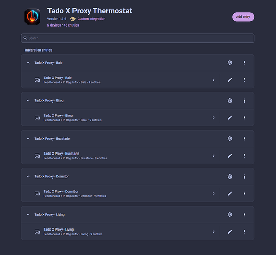

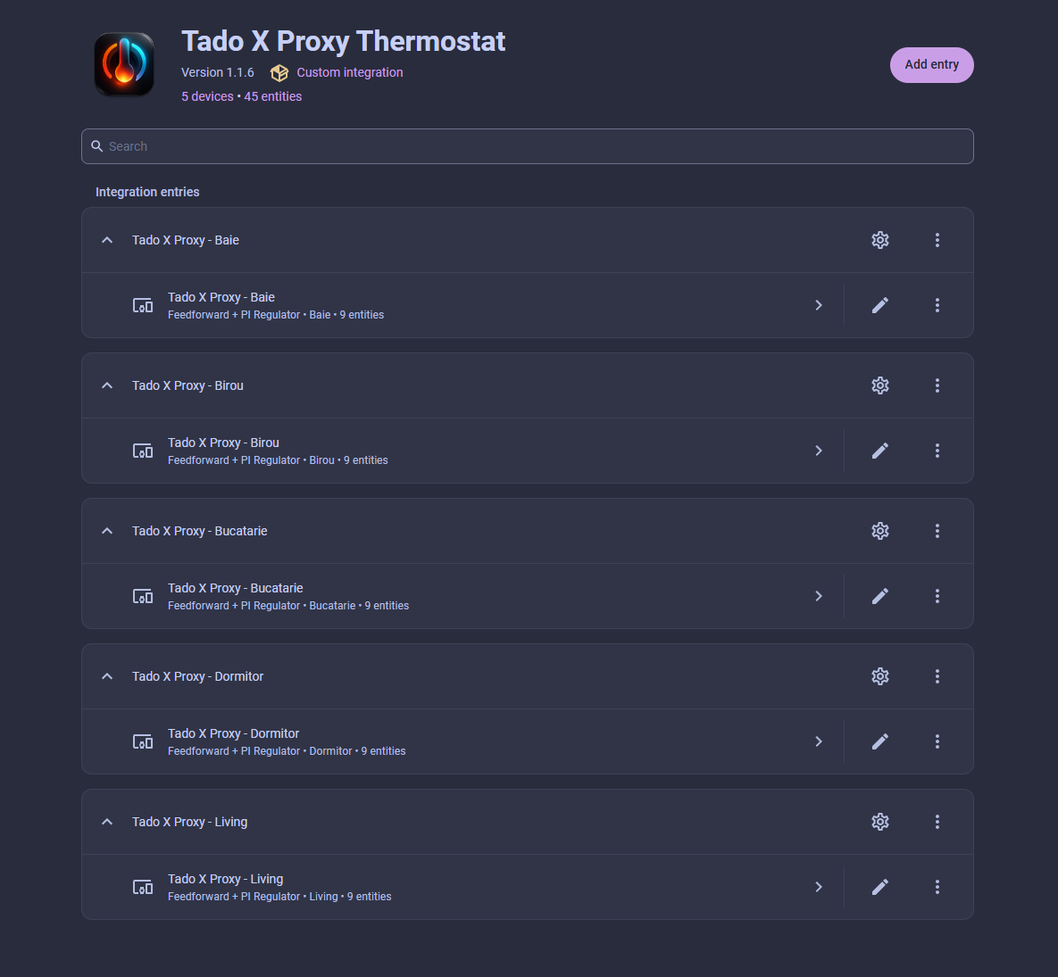

So I understand to set up the Proxy thermostat for the lounge, what do I do about all the other rooms so I get the home/away and scheduling features of Home Assistant to work?
If I read well your question, you add Tado X Proxy Thermostat as 1 device per room where you have a TRV active. See my screen, 5 rooms with TRVs, 5 proxies integrations, each with their own settings/schedule, etc.
Thanks, do you have an external room temp sensor in each of your rooms?
