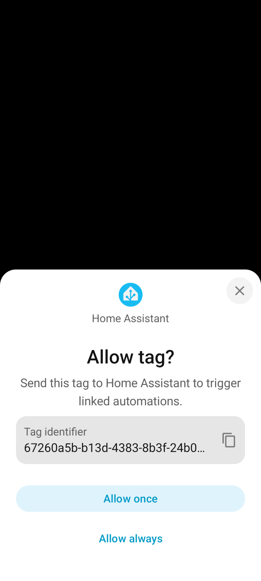

Just to be clear about what I'm talking about, here's what I get when I first scan a tag, and if I click "Allow always," it's game over--there's no way to reverse the decision. If you really can't undo it, there should at least be a warning that this is an irreversible action short of maybe reprogramming the tag with a new Id. But for any given tag UUID, there doesn't appear to be a way to request permission if you've ever clicked allow always.
Another terrible thing about this UI is that I assigned human-readable names to all of my tags, but the names don't show in the authorization prompt. So you have to memorize the hex numbers to know what you are authorizing, which in turn makes it extra painful to condemn a UUID that you have memorized.
