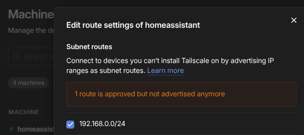

I had the same problem after updating to 0.29. By going into Tailscale, and opening Route settings on my “homeassistant” machine, I found the subnet that I previously configured but which wasn’t advertised anymore (note, screenshot shows the fixed state):
Adding the same subnet in the Tailscale app configuration in HA under “Advertise subnet routes”, immediately let my phone connect via the app using Tailscale.
