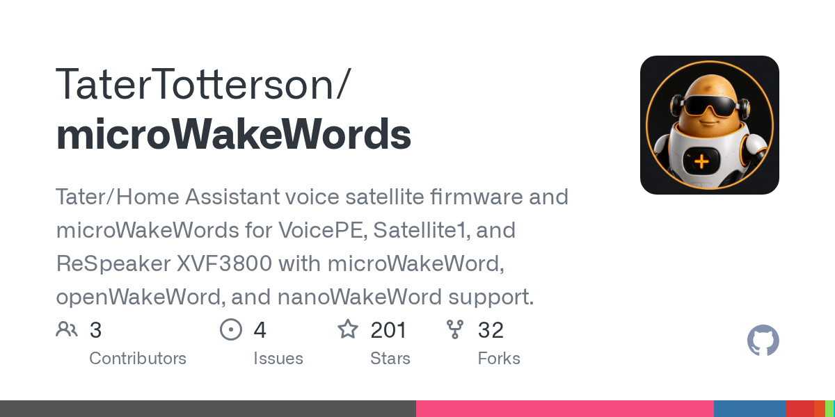

Still taking requests, but here’s a repo I was pointed to in another thread that also contains a ton of microWakeWords in ready to use form (amongst other things):
