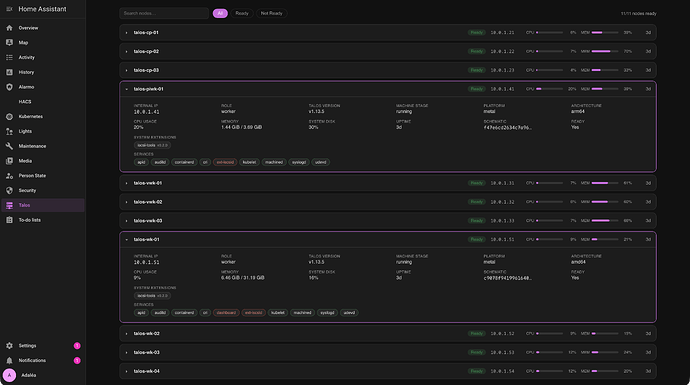

The optional Talos sidebar panel shows more than the entities do: every node as a row with ready state, IP, CPU and memory bars, and uptime, expanding into the full detail grid, installed extensions, Talos service health, and etcd members. The entities and services work without it.
