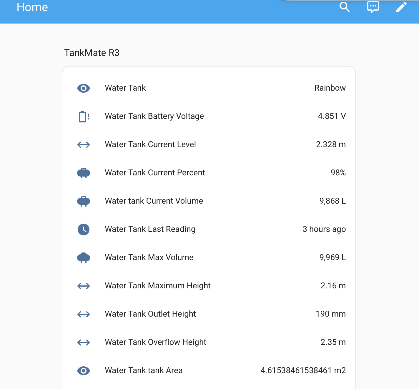

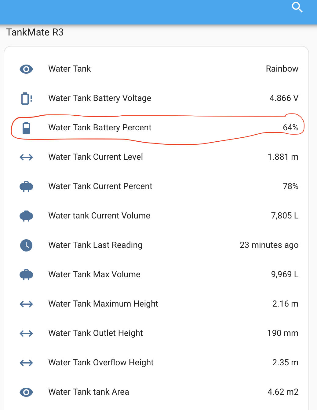

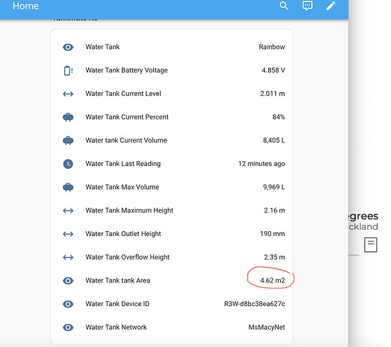

Thanks for the YAML Hugh & Simon. I added it to my HA and have got it calling the TankMate API for my sensor, which incidentally I need to re-calibrate as I have made some guesses on the tank dimensions, so some of the readings are out.
I’ve “recalibrated” the sensor by tweaking the tank dimensions in the app, so the reported parameters are now more realistic. Also I think a scan_interval of 2000 or longer is better given the sensor only sends updates to TankMate twice a day. The app also displays the battery % but the YAML code doesn’t calculate this. Not sure how to add this - perhaps some local calculation/formula is required?
The water tank area could do with having only 2 decimal places :slight_smile: Again, so local formula is needed to do this.
Adding a float/round(2) to the tank area state_attr in YAML fixes the returned value to 2 decimal places.

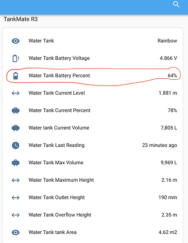

I’ve added the following YAML to get a battery percentage. Based on my particular model of TankMate and battery type, with the app reporting 4.8V as 64%, the formula needed a divisor of 7.59, then round off to a whole number:
water_tank_bat_percent:
   friendly_name: "Water Tank Battery Percent"
   value_template: "{{ (state_attr('sensor.water_tank', 'R3W-d8bc38ea627c').batVoltage | float / 75.9)|round(0) }}"
    unit_of_measurement: "%"
    device_class: battery

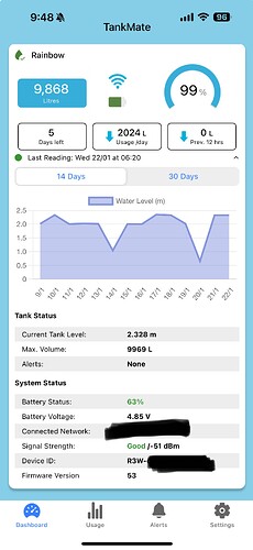

Ah, no sorry, I was looking at your post and I realised it’s just a screenshot of the app on your phone :joy:

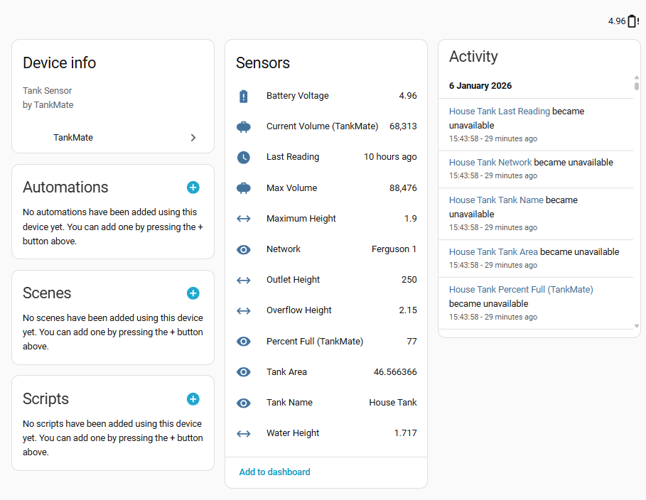

Hi Simon i came across you post, i have 3 x Tankmate sensors id like to intergrate into HA also, do you know how to grab hold of the api for these, im using chatgpt to help out as i dont have any coding experience, any help much appreciate. Alan

Hi guys

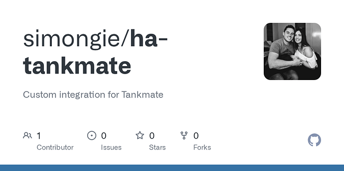

I’ve made a custom integration that you can install via HACs and a custom repository. I dont REALLY know what I’m doing, so please let me know if it doesnt work for you.
This should auto-discover any tanks you have and set them up accordingly.
Repo here:
