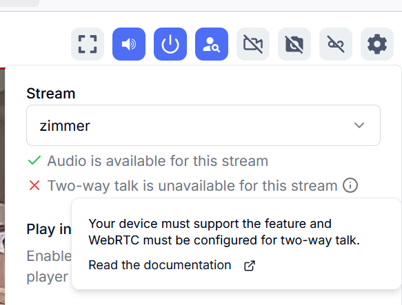

i have working Audio but no working webRTC / two-way talk.
Tapo C225 camera.
Frigate in a Docker with host Network without Home Assistant…

I did have the IP of my Host in the Candidates once… didn’t help.
      - 192.168.1.5:8555
Any clue on how to enable WebRTC ?
