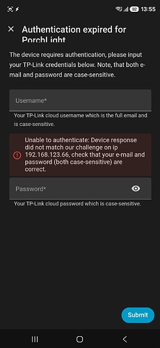

Hi, I’m frequently getting the follow error on Tapo Sockets. Authentication required for device x. If I’m home in the local network I enter username and password and it’s OK. If I’m away, entering the user name and password via the nabucasa app fails every time. Is there a known bug in the app? Pete

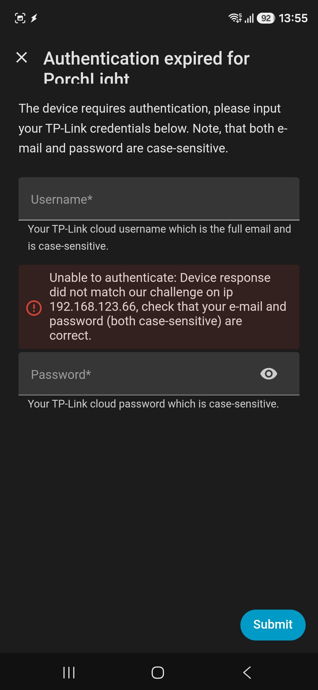

I add it’s not so much it happens, but that using the correct user/ password I can only correct it on the local network. Via the app, it’s always rejected as in the screenshot
Just as an update I am now back and entering the same username and password locally has cleared the error

Is x.x.x.66 the ip of your local device, or the IP of the device you are using th APP in ?
