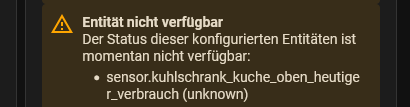

I purchased a 3rd Tp-Link Tapo P110 recently and connected it to the same network as the other two. Added it to HA and it seemed to be working OK.
However, intermittently it becomes “unavailable” on the network and the HA log is shown below.
Everything seems up to date and at the same revisions as the other two P110’s:
https://i.imgur.com/BuE3rZH.jpeg
There does not seem to be any pattern to when it goes into the unavailable state which can last from 2 to 10 minutes. WiFi Signal is excellent as it’s only a few metres from the AP.

I’m having a similar issue here. I’ve added some more tapo plugs to monitor energy usage. All of a sudden all of them (old an new) are not showing up in the energy dashboard anymore.
could not find something related to that error in the log
