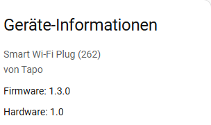

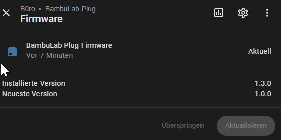

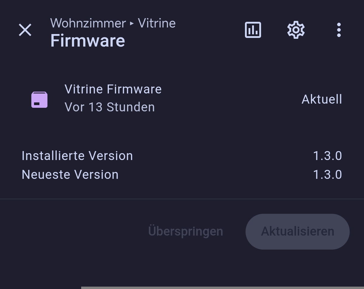

I have just updated The P110M via Tapo App to the newest firmware 1.3.0.
In Homeassistant I see that the installed version is 1.3.0 (correct), but the newest firmware shows 1.0.0.
Does someone know why HA does not show 1.3.0 as newest?

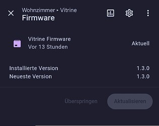

Shows correct info here

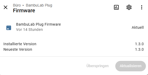

Restart HomeAssistant and refresh your browser. Does that make a difference?
Today it shows 1.3.0!

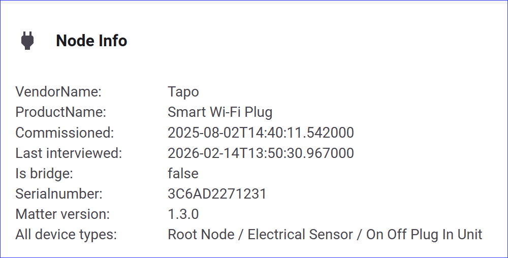

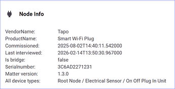

HA is actively interviewing the device. So either the 110M answers with wrong information, data are not correctly processed by HA - or the server pretends it updates info without actually doing it. :grin:
Is it not because it’s reporting the matter version not the device firmware version?
