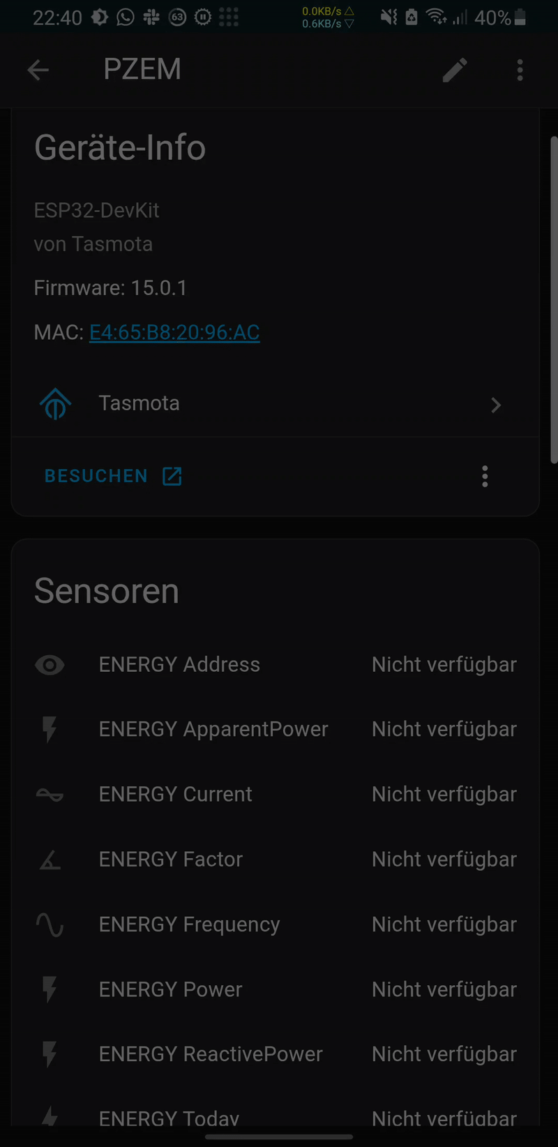

Now after configuring mqtt on home assistant, the two devices were discovered successfully, however sensors are keeping constantly reloading and being unavailable! I made a gif of this behavior, very weird…

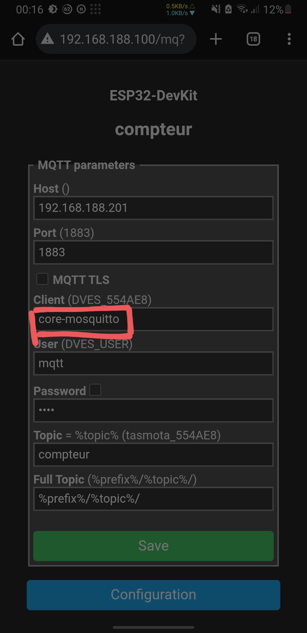

Maybe, my mqtt configuration is faulty !
Is this correct? I did understand that the client should be the mqtt broker and that’s why it is the same for both of the esp32.

I think the client is a name you give the client ( the tasmota device ) so you can recognize it in error logs and such. It probably pops into HA as well as the entity.
They should be unique…
So the client connects, sends the data, then a new client with the same name different IP connects, drops the old connection, then it does it again… and again…
Yep that’s what’s happening.
Nope. The client is to identify the device, not the broker.
You can use the same username and password for both devices but they must have unique client ids.
What tom_I said. And topic must be different on each device.
