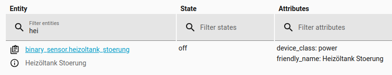

After reloading, the resulting entity is binary_sensor.heizoltank_stoerung and its initial state value is unknown.

The binary_sensor correctly reported off.

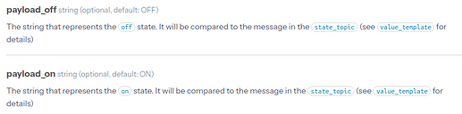

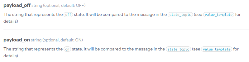

The main difference between my configuration and yours is that I removed the payload_off and payload_on options. Their default values are OFF and ON respectively so there’s no need to include them.
From the documentation:

Changed the name of the binary sensor via the HA UI to binary_sensor.heizoltank_stoerung.
But the value is not changing
Now it works.
