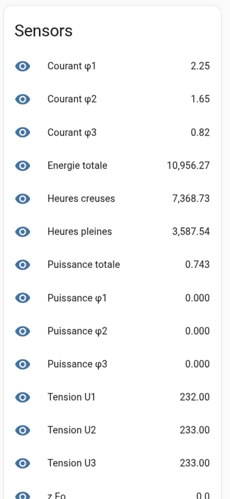

I have a Tasmota integration with all sensors showing and usable, but nothing is sent to InfluxDB.
How could I investigate, or fix this ?
