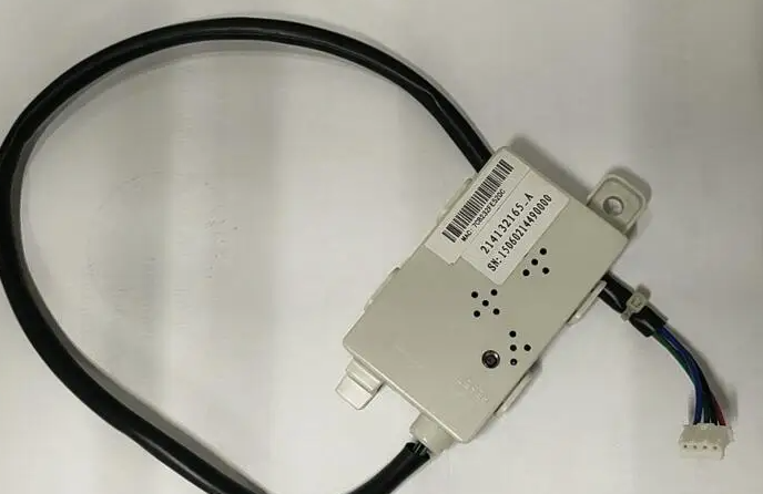

I myself am using the TAC-12CHSD/XA71. The unit comes with a wifi module, which if I am correct has a broadlink wifi chip. I did order the slwf01pro v1.1 back then in the hopes it would work, but due to the different communication it was not applicable for me. I did buy a logic analyzer to check the TX/RX communication for reverse engineering, but never got to it. After all these years I am still looking for a way to locally control my AC. I don’t really care for MiM solutions, if I can get rid of the TCL chip with mandatory cloud access and the crappy Chinese SW would be a big bonus. So I am not sure if your solution will work with the TAC-12CHSD/XA71. But I am very interested in your reverse engineering process and maybe I am able to replicate this for my type of AC.
This is the wifi-module connected to my AC.
