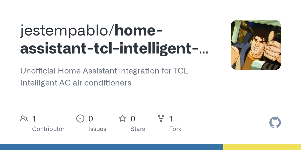

TCL Intelligent AC custom integration for Home Assistant / HACS
I built an unofficial Home Assistant custom integration for TCL Intelligent AC air conditioners.
Repository:
Tested with:
  • TCL XA71I
  • Intelligent AC Android app 1.0.12
  • United States / Other region
  • local LAN control over BroadLink/DNA framing
The integration controls the AC locally over LAN.

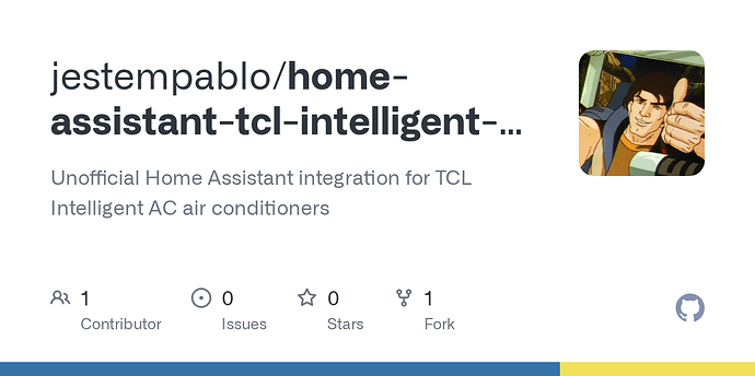

Installation:
For now, add it as a HACS custom repository:
A PR to include it in HACS default repositories is open here:
Feedback, model reports and logs are welcome, especially from other TCL / OEM models and regions.
