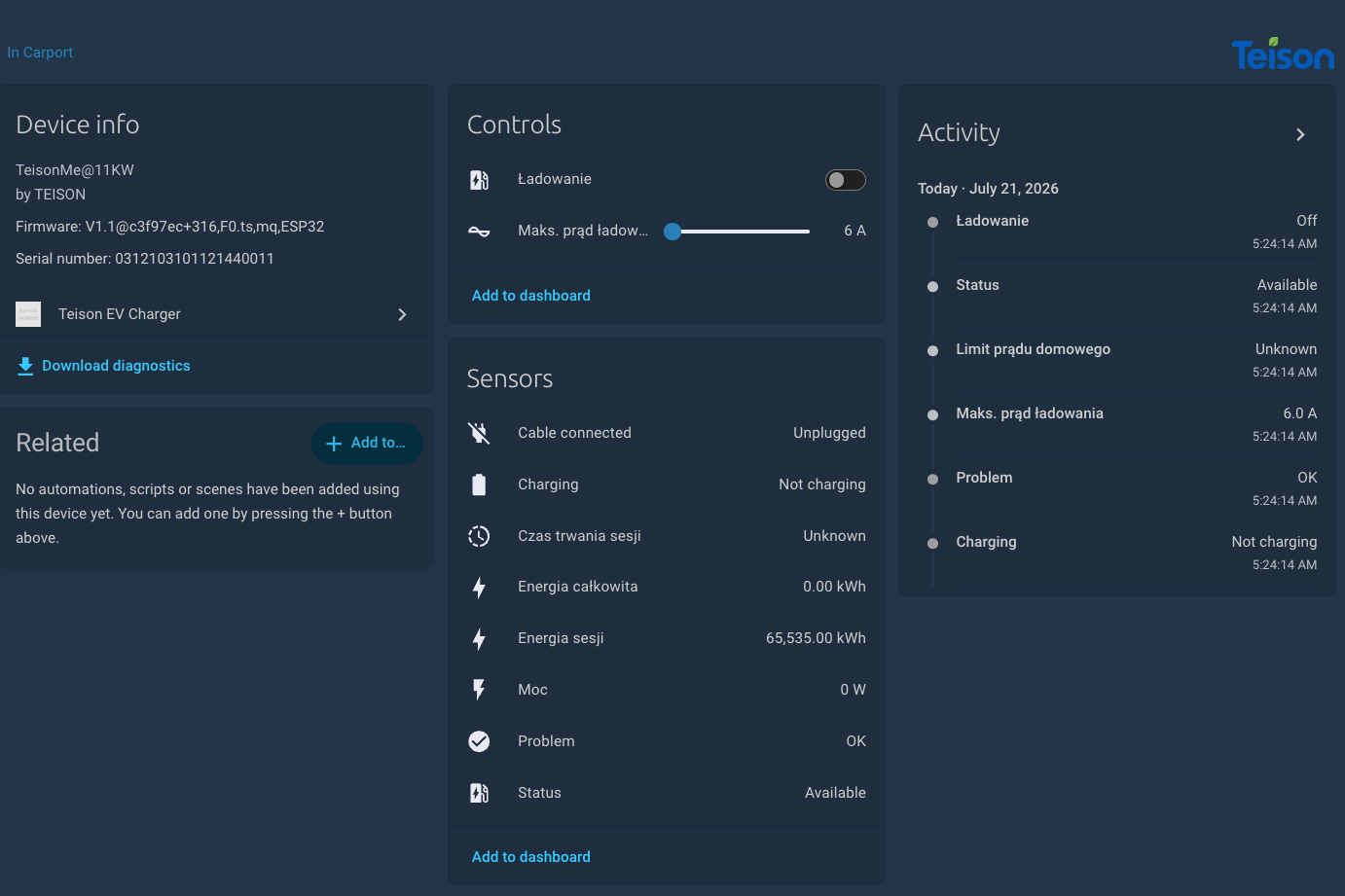

A native HA custom integration for Teison Mini WiFi chargers (the My Teison / Teison Me app ones). Talks to the same cloud API the apps use - no OCPP, no add-on, no MQTT broker, no YAML. Install, pick your cloud, enter your app login, done. Handy for units whose firmware doesn’t do OCPP.
  • Both clouds supported (My Teison + Teison Me) via a dropdown
  • sensor: status, power, session/total energy, temperature, per-phase V + A (L1–L3)
  • switch: start/stop · number: max current, household limit
  • UI config flow, re-auth, multi-charger, diagnostics
Install: HACS → Custom repositories → add the repo (category Integration) → restart → Settings → Devices & Services → Add Integration → Teison EV Charger.
