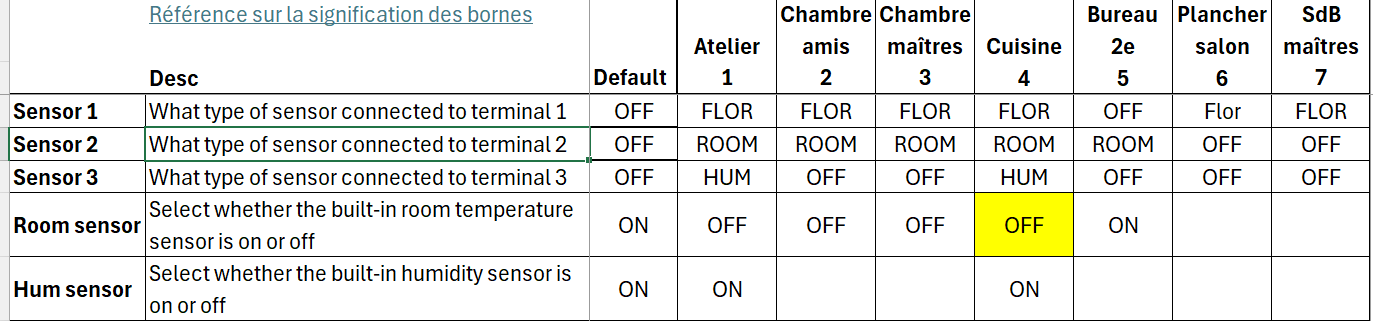

Hello again,
So the Floor (slab) setpoint is available with thermostats 6 and 7, which only have Floor sensors.
However, the protocol manual mentions this:
“Slab setpoint was availble in prior versions if no room sensor was configured. With protocol version 3 the slab setpoint message can be used as a slab minimum target temperature when both room and floor sensing is configured.”
Considering my config, do you think there would be a way to activate it for the other thermostats?

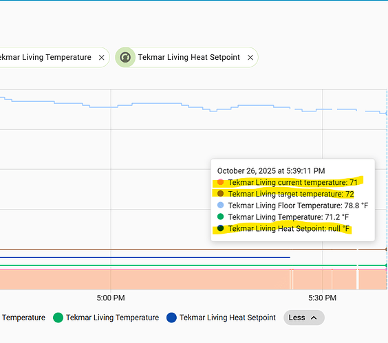

Originally, I had “Setback” disabled and the sensor readings mostly made sense. I setup a 2 Event schedule (day/night) and realized some data stopped getting sync’d back to HA until I re-read the documentation regarding enablement of “Setback”.
With that being said, here is what I’m seeing:
Questions:

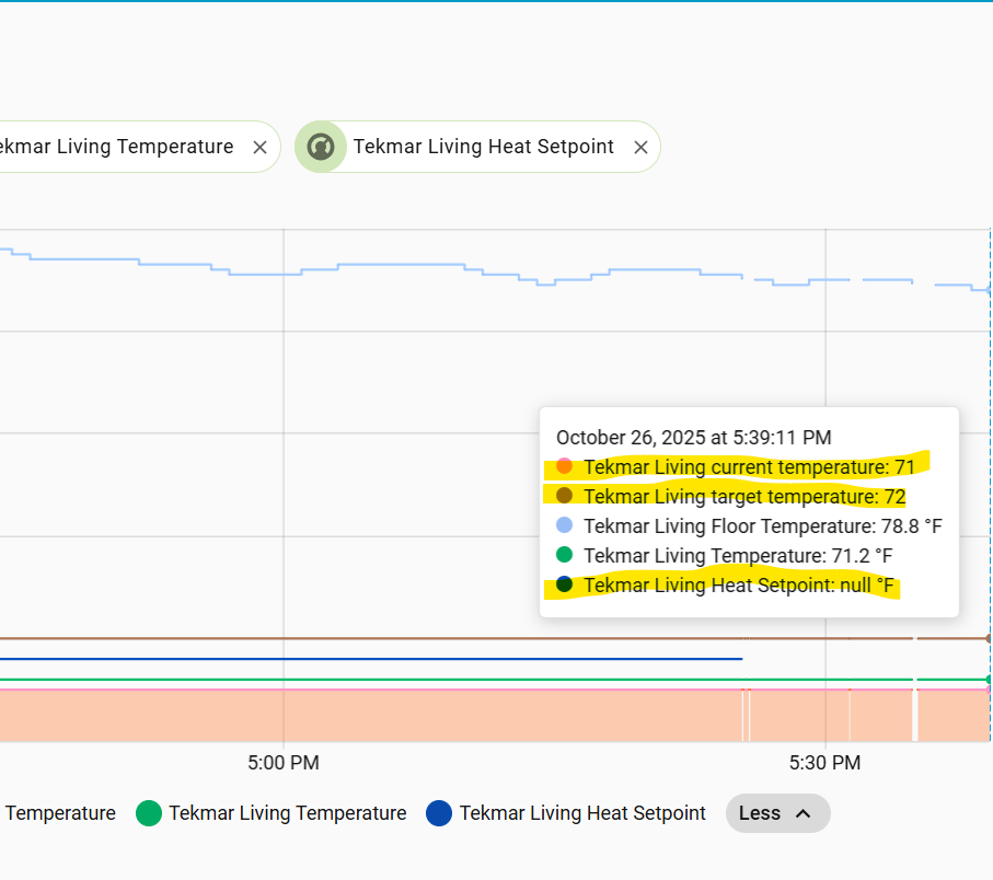

  1. Tekmar Living Temperature: Can I assume that this is the Air Sensor reading? I am targeting 71F, so it’s pretty much spot on within 2 tenths of a degree.
  2. With the Setback Enabled, should I assume it’s OK that the Tekmar Living Heat Setpoint is “null”? That value was not null when I had Setback disabled…
  3. This is probably that one I’m most confused about: Tekmar Living target Temperature is 72F even though my schedule on the Thermostat is set to 71F… is it somehow rounding values?? Notably, however, my temperature is spot on, so seems to be working as expected (assuming Tekmar Living Temperature is actually the Air Temp sensor…)
  4. What is the difference between Heat Setpoint and Target temperature?!
  5. What is the difference between Tekmar Living current temperature and Tekmar Living Temperature??

Questions:
Yes, it is the air sensor in the thermostat itself (or an external air sensor if the thermostat supports one and is configured to use that instead of internal).
  1. With the Setback Enabled, should I assume it’s OK that the Tekmar Living Heat Setpoint is “null”? That value was not null when I had Setback disabled…
Correct; that’s because when you enable setback it uses three separate number entities for each of the setback states instead of a single one. You can see (and may need to enable if they were created as disabled) the other ones in the device page. Under Controls it will show them or have them hidden under “X disabled entities”.
With setback mode enabled there are three different setpoint number entities available: Day, Night, and Away. The Home Assistant climate entity can only handle one, I map one of those three to the climate entity depending on the setback state.
  1. This is probably that one I’m most confused about: Tekmar Living target Temperature is 72F even though my schedule on the Thermostat is set to 71F… is it somehow rounding values?? Notably, however, my temperature is spot on, so seems to be working as expected (assuming Tekmar Living Temperature is actually the Air Temp sensor…)
Yes the rounding can be weird. Internally the Tekmar gateway uses its own magical unit for temperature called “Degrees H” or “Degrees E” that are not C or F and I have to convert those values first to C (which is what HA wants internally) and if F is selected for display C gets converted to F. So there’s three conversions happening to get from gateway H or E → C → F which has random rounding errors.
I am also in the US and use F, but I haven’t thought of a way to improve the whole multiple conversions thing yet. I may have to make a table of E/H values that map to a C/F value rather than trying to use math and rounding.
  1. What is the difference between Heat Setpoint and Target temperature?!
  2. What is the difference between Tekmar Living current temperature and Tekmar Living Temperature??
I believe that is just duplicates from the entity and the HA climate entity, one rounded to zero decimal places and the other with 1 decimal place.

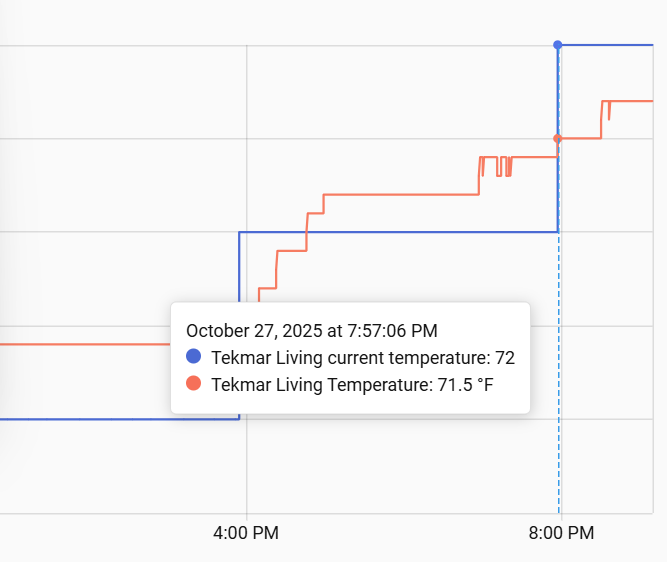

Thanks for those details regarding the quirky/rounding, conversions, etc… I may try converting the thermostats to C since it appears C supports .5 degree granularity, whereas F supports only whole degrees… but what you described actually makes total sense.
Just poking around this one a bit more, it seems like maybe it rounds Down up to .4 degrees (or just drops it), and once it hits .5 degrees, rounds Up:
For example, I tracked this throughout the last couple days and anytime Tekmar Living Temperature had temps 71.0F through 71.4F, Tekmar Living current temperature was showing as 71F, but as soon as Tekmar Living temperature hit 71.5+, Tekmar Living current temperature showed as 72F… I understand it enough now to know I should be focusing on Temperature vs. current temperature!
