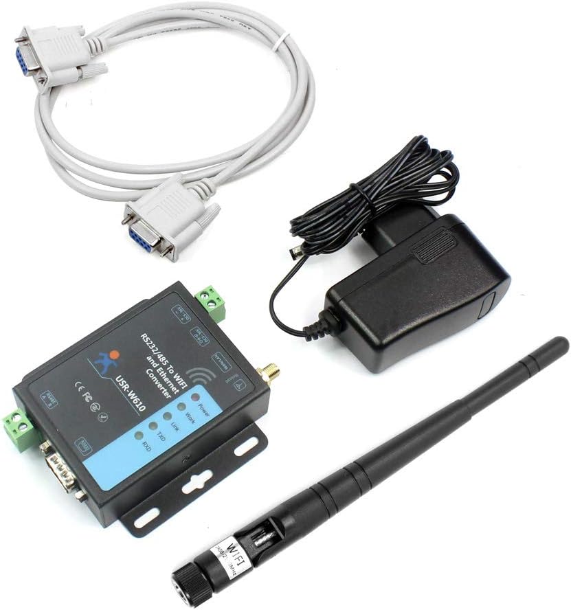

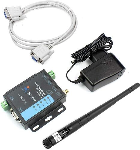

This low cost serial to TCP adapter was confirmed as working by another user:
But anything that supports TCP Socket or RFC2217 should work.
This one is wireless:
I have not personally used either of the Amazon ones, I use a Perle IOLAN SDG2 W. The 1 port version looks to be on eBay for around $280. The Perle serial are much more expensive.
