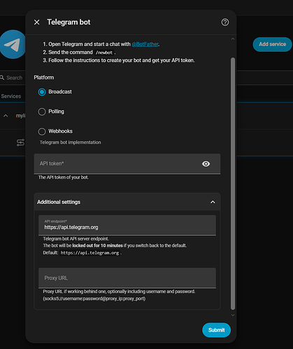

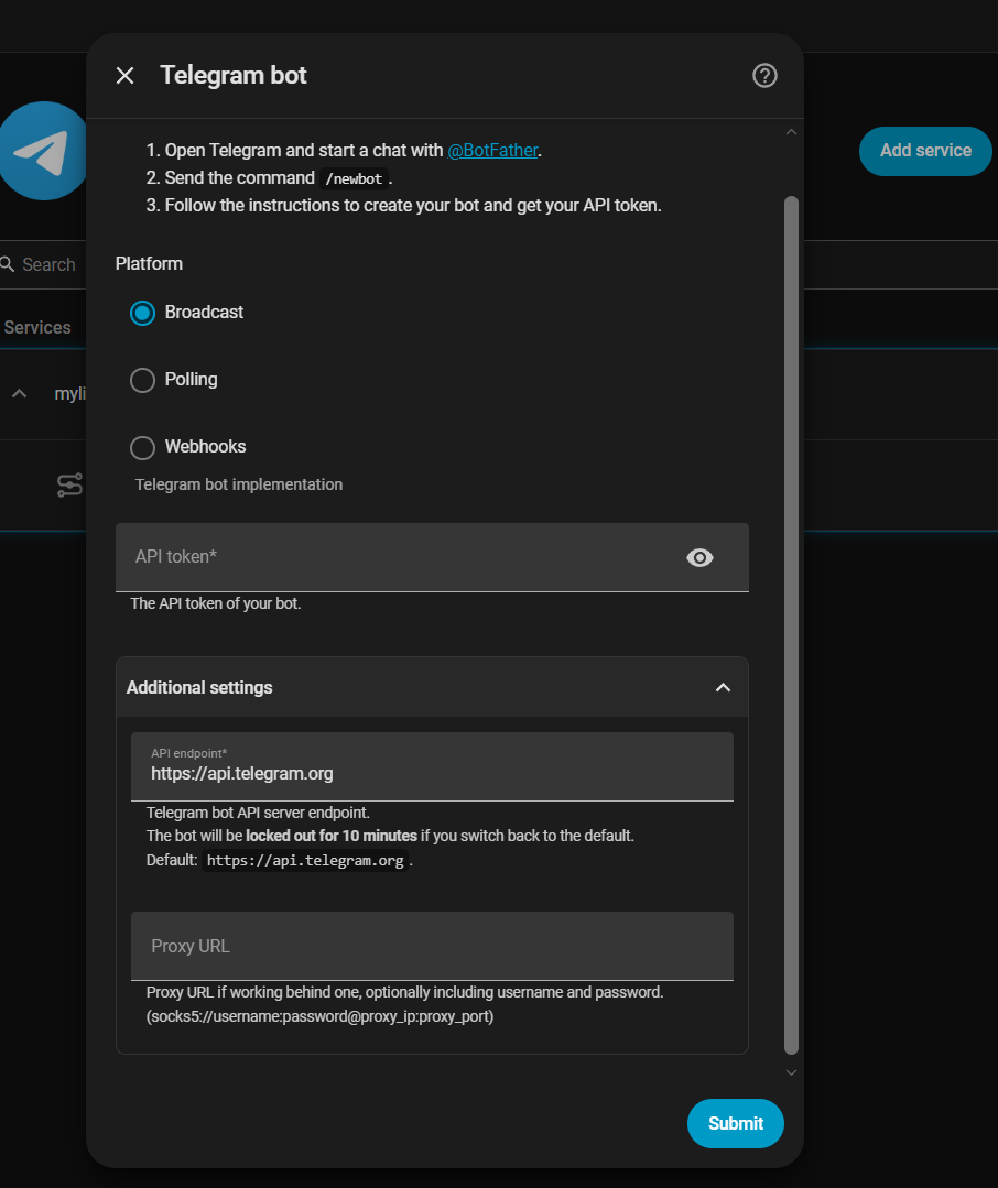

https://www.home-assistant.io/integrations/telegram_bot/ I read this guide, and did a google search on telegram integration with HA. It explained how to create a bot, to get your API key, and chat IDs for your Bot. I did all of that, and then go Devices and Services > Search for telegram. I selected Telegram bot. I then entered in the API key which is an alpha numeric string separated by a : I selected broadcast as I did not know how to set up anything else.

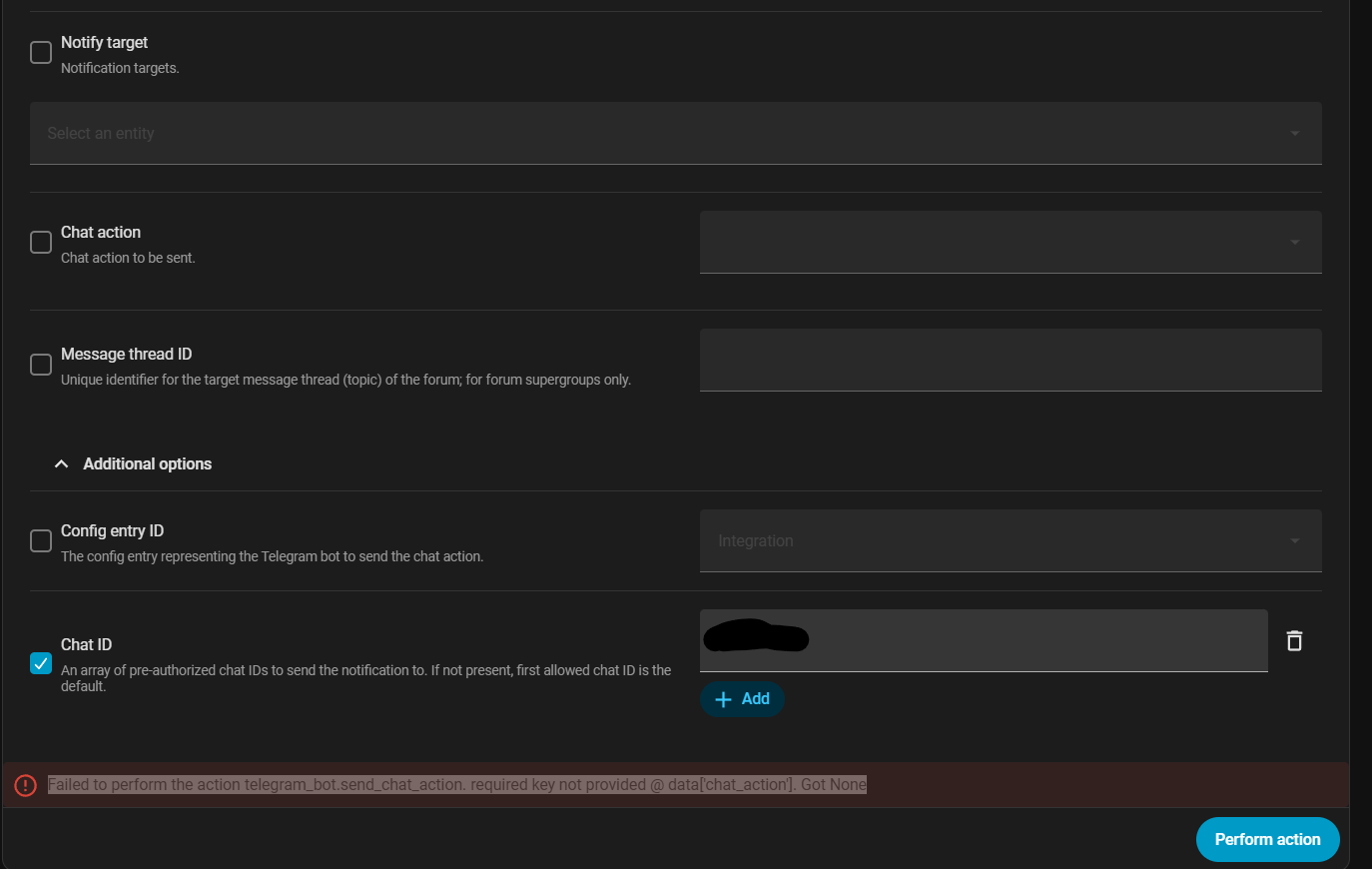

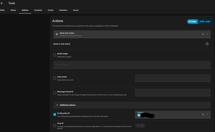

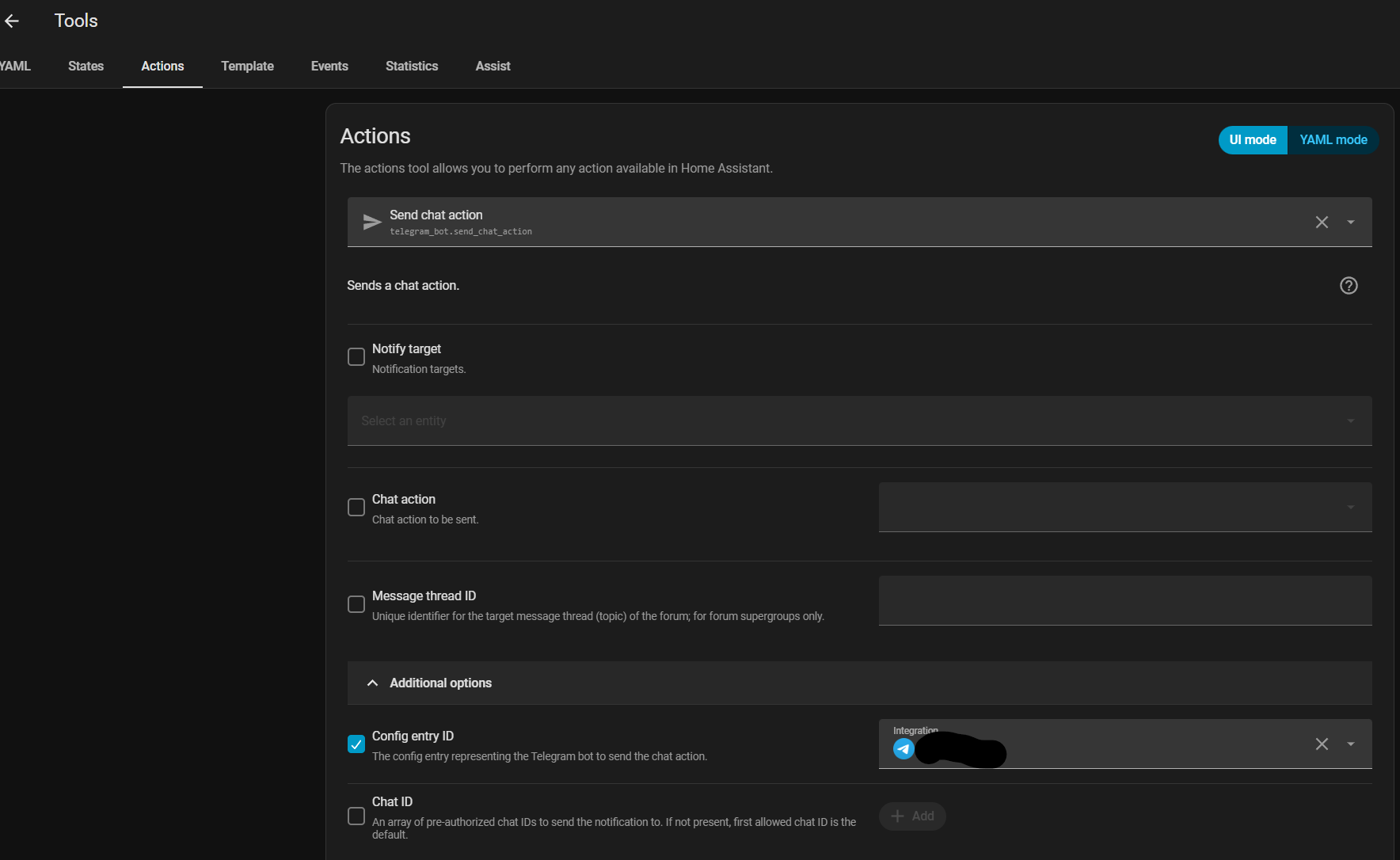

I think I got everything that’s needed. Both tests were run in the debug, and I got the same message for both.
I went through the logs post test, and this is all I could find.
Log details (ERROR)
Logger: homeassistant.components.websocket_api.http.connection
Source: components/websocket_api/connection.py:331
Integration: Home Assistant WebSocket API (documentation, issues)
First occurred: 3:17:26 PM (2 occurrences)
Last logged: 3:19:38 PM
[3539330771152] Error handling message: required key not provided @ data['chat_action']. Got None (invalid_format) Aaron from 172.30.33.2 (HAA-Addon/1.0.2)
Failed to perform the action telegram_bot.send_chat_action. required key not provided @ data[‘chat_action’]. Got None
type or paste code here

Is the action missing in your code, or does it have invalid contents?
It looks to be empty in your first screen shot.
The error log confirms it.

I do not have the answers to your questions. You go to settings > Devices and Services > Add Integration > search for telegram, click on Telegram > Telegram Bot, enter in your API key, and you are done. You select webhooks, or something else, I just did broadcast. As setting up the other two seemed like a pain.
I do not know if there are other fields that need to be modified. Those are the steps I took.
