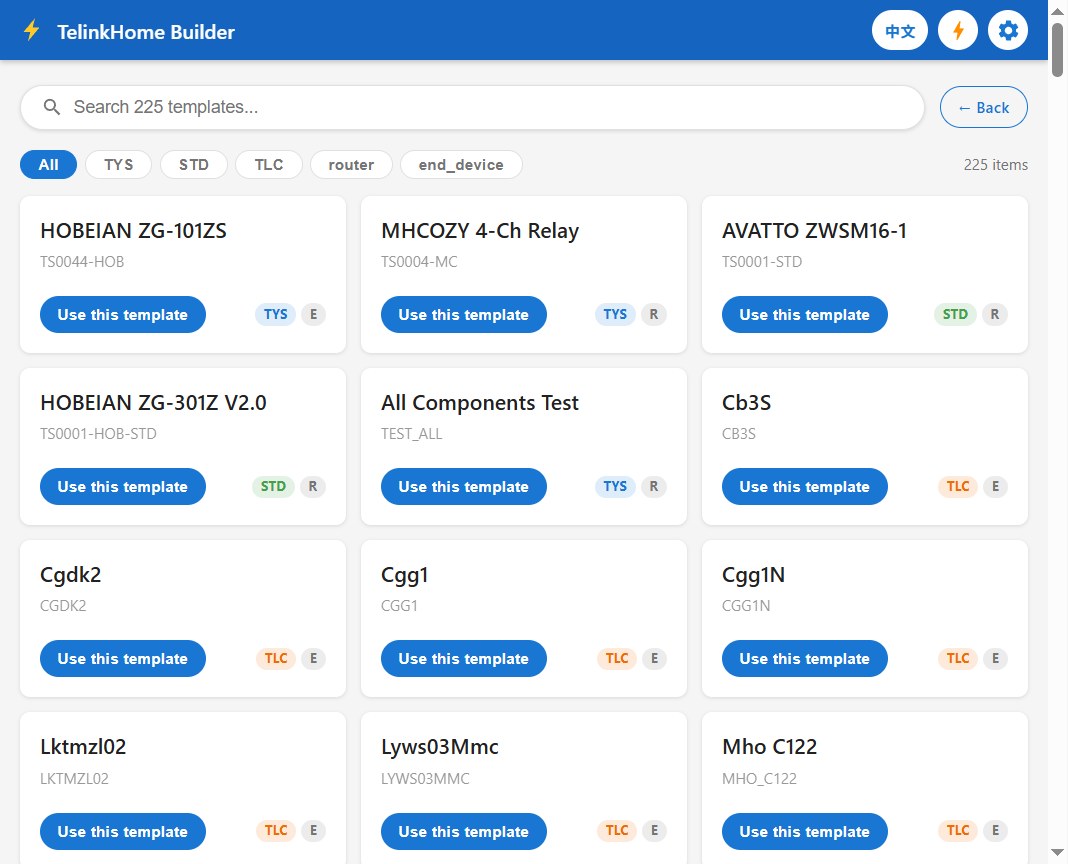

- Template-first: 220+ known device templates (TS0001, TS011F, TS0201, …) — pick one, tweak a few pins, compile

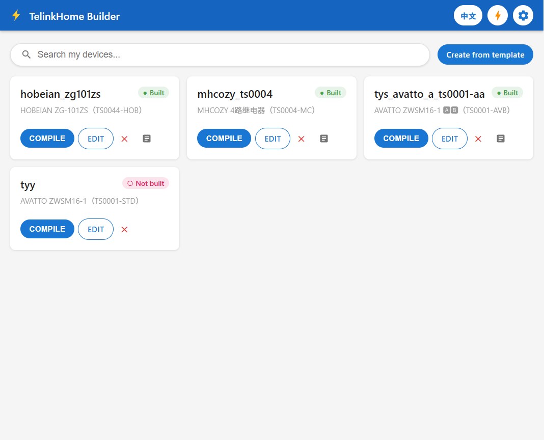

- CLI —
tlh build devices/xxx.yaml - Local web dashboard —

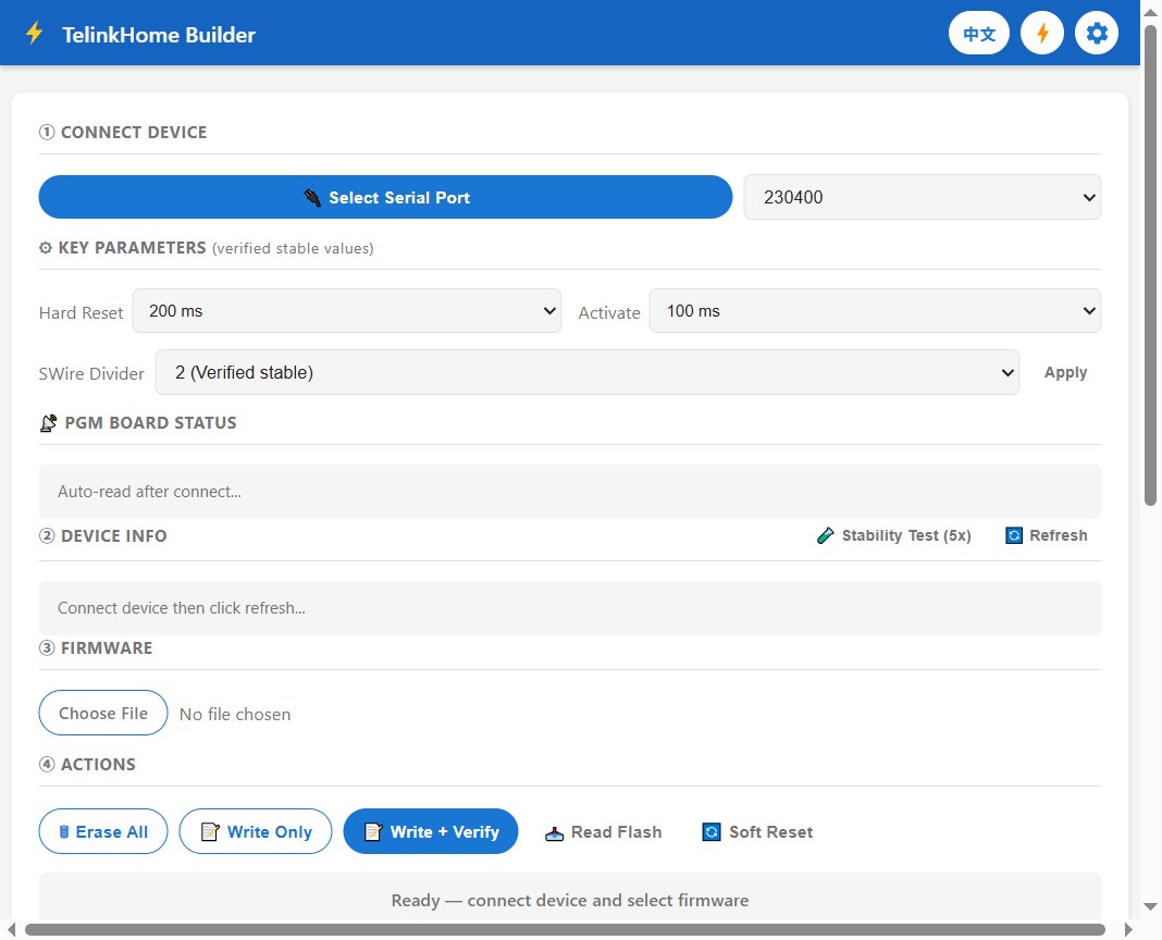

python -m www, manage devices and compile in the browser - Home Assistant add-on — TelinkHome Builder: compile and flash right in HA, no command line needed
