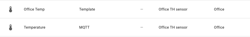

The sensors are assigned to the right area and have the correct class configuration:
state_class: measurement
unit_of_measurement: °C
device_class: temperature
friendly_name: Office TH sensor Temperature

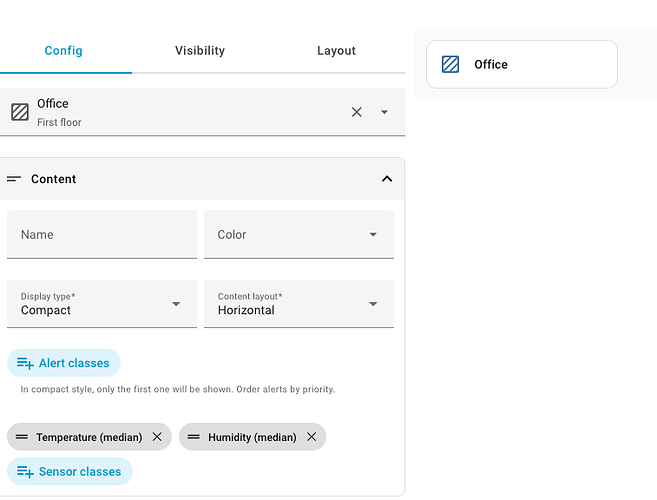

I even tried creating a template sensor but they are not sowing up. The area configuration has temperature and humidity added but it’s not showing it.
What am I doing wrong?
Check the area settings, you may need to select the new entities there.
That’s it! Thank you so much!
