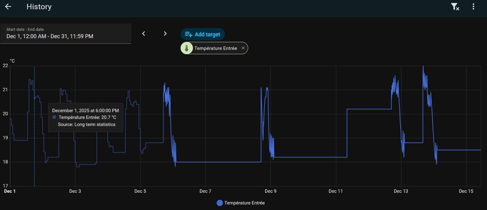

Here is a screenshot of the temperature recordings :

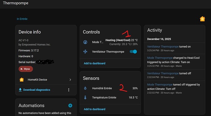

Also, I just found something weird.

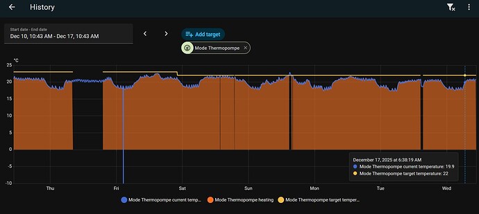

If I go do settings, devices, Homekit, select the Mysa and click on the “mode” history, everything is recorded like you can see on the picture below :

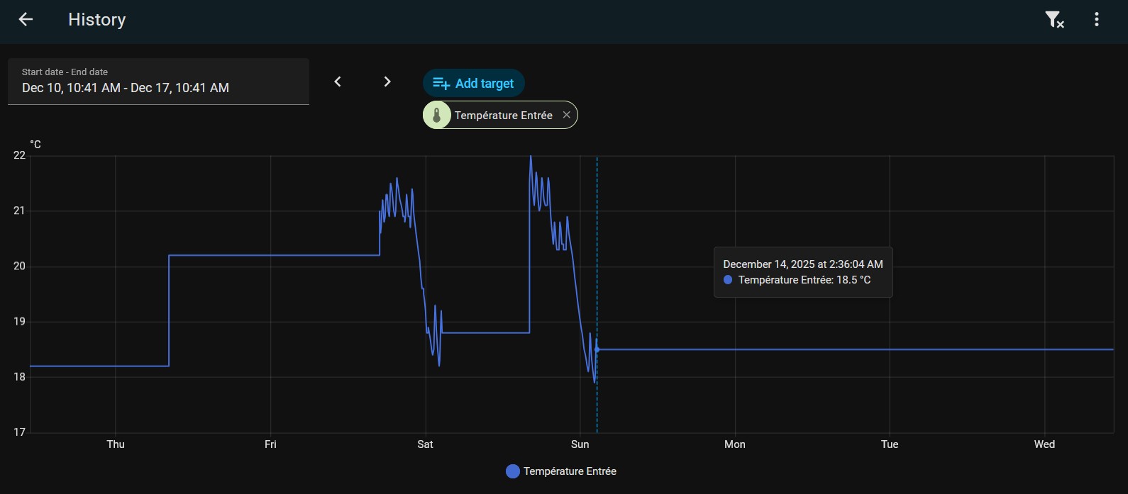

But if I go on the temperature history, I can’t see anything recorded after Dec 14th 2:36 AM :
This is really what’s bugging me, the records works for everything in HA except precisely temperature and humidity on this particular Mysa, even if the temperature in the “mode” history is recorded correctly…

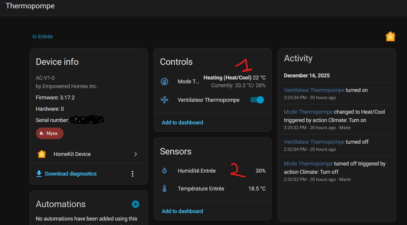

Those are separate entities… are they the same device or a different device?
From the same device.
First graph come from entity 1 and second graph from entity 2
Edit : I made a mistake, the red 2 should be near the temperature entity.
This is likely just a bug then if the Mode T… has the current temperature
To my understanding “red 1” is your Heating Pump, and “red 2” is a Thermostat(with a Thermometer) and this is placed in the Entre
Do you have other Thermostats which control Your Heating Pump ?
EDIT: Guess i was wrong , it looks like 1 is the Thermostat(device) in your entre, from where you control your Heating-Pump, and 2 is the thermometer in that(device) or other way around, beats me,
Anyways it seems like it’s “connecting/talking” to your heatpump over IR, so make sure it’s within reach of your heatpump, and 2.4 GHz WiFi connection(if the wifi-connevtion works flawless, the graphs behavior is most ike do to problems with connection to/from Your Heatpump
